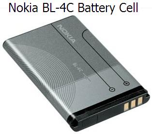

Ziddik never said what is the type of battery in his cell phone. Lead-acid? Ni-Cad? Ni-MH? Lithium?
Don't all modern Lithium cell phone batteries have a 3rd contact for the thermistor inside?
Ziddik's "charger" does not use it.

there are some chargers in society sold by China( see link https://www.amazon.com/Universal-Mobile-Phone-Battery-Charger/dp/B001AHU6QU )
These have two adjustable leads and nothing more other than mains connecting pins on the other side
the clip is pressed and battery with proper polarity is placed inside.
For universality, the pins are to be adjusted to make contact with battery terminals.
Audio guru may wonder that this item is sold on amazon.com
so the thermistor etc are not cared, even though it was incorporated for safety.
As such perhaps Ziddik might also be using his charger.
No doubt that these chargers are highly dangerous and the battery might explode.
yes we heard cases of Chinese batteries sold as replacements exploding.
