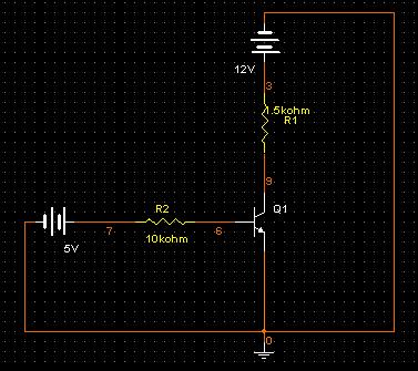

I'm studing transistor right now, but I came out with some practical questions. Some of you may know the JDM pic programmer.
My question are about Q2. Base is conected to 0V across R1, and colector is attached to a RS-232 signal (DTR, aprox +/- 12V) across R2. Chip is fed at 0V and grounded at -5V.
The theory says : when DTR is high (+12V), the transistor works as an emitter follower, with emitter voltage at Vb- 0,7... First problem here. Why? What is really connected to the emitter?? I drawed a diagram cricuit attached. If it is fine, Ve should be 0V, and Vb shoud be 0,7 (common emitter, base biased), and it is not an emiter follower... What is wrong in my diagram??
I can't see anything wrong, it's a straight forward common emitter switch circuit. Ve will be 0V, as it connects to the 0V line, likewise Vb will be roughly 0.7V, it can't be anything else - the collector voltage will be fairly low, depending on the current gain of the transistor.
An emitter follower by the way is a common collector configuration.
That's exactly what I think.. but the transistor in the JDM circuit doesn't work like that. When collector current is high, +12V, Q2 works as an emiter follower, that is, common collector. I really CAN'T see this..
this is how it works in the circuit, as the author says, and is how a high byte is sent to the serial data output...

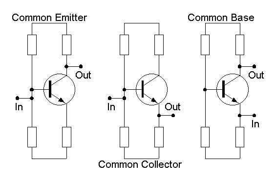

Do you mean reading or writing to the PIC?. If it's reading the PIC, it works in common base - if it's writing to the chip it doesn't 'really' work in any mode, but it's essentially common collector.
Here are the three basic transistor configurations, notice that they are exactly the same - except for how you connect to them.

Yes I understand that, thanks :)
But, what I don't understand is why when writing to the PIC it is in common colector, as emitter has no resistor, and base does have one. Vb should be Ve + 0,7V, depending on Ve. and it seems more a common emiter.
But what really happends is all the way round, Ve depends on Vb as any emitter follower. But, where's the emitter resistor?
As I mentioned before it's not 'really' working in any configuration, but when DTR is high the transistor switches on, the base will be 0.7V below the base, and the collector will be slightly above that - R2 1.5K provides the current for that. When DTR goes low (-12V) Q2 stops working as a transistor at all, as the collector is 12V negative of the base the base/collector junction will act as a forward biased diode, so the voltage at the base will be that set by the ratio of the potential divider R1 and R2, this will allow the pin of the PIC to go low, with the base/emitter junction acting as a reverse biased diode to prevent it going negative.
The input resistance of the PIC itself.
Ah! It is that. the input resistance of the PIC was not included in my diagram. So the emitter really is conected to a resistor (the input resistance of
PIC), isn't it? This way yes, Ve will be Vb - 0,7V. But appart from the resistance, it is grounded as in my diagram, isn't it?
Anyway, as the base has a 10k resistor, there will be a voltage drop across it... input resistance of PIC should be much higher for it to still be a high pulse.
Damn, this programmer is really tricky.. but good to learn new things ;)
About that "inverted mode", current flows from base to colector, but what happends to the emitter current, flows from emiter to base? or viceversa?

You're thinking too complicated!. The transistor is NPN, so it's essentially two diodes, NP and PN, when DTR is low the emitter/base diode is reverse biased and turned off.
Ups, you're right.. Fine, all clear now. It is that I'm studying transistors now and this kind of working is not what I've been hearing about... thanks ;)
