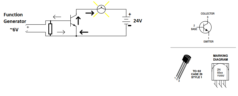

I am new to electronics. And somehow I got the following task:
goal: Amplification of signal from function generator (FG) using home-built circuit based on transistors.
details:
FG output -6 - +6V.
needed output after amplification -24 - +24V.
details I have -
FG
transistors TO92 2N5551 936 (others can be ordered)
resistors - any
DC Power supply - 24 V (can be regulated).
Frequency this thing will operate in - 1-15 Hz
diodes and capacitors can be ordered if needed.
I already built a simple amplification circuit for DC output (shown attached), but now it turns out I need alternating current in the output.
I researched and stumbled upon Push-and-pull amplifier circuits. But if I understand correctly -- these will output -12,5 V to + 12,5 V range, right?
Can you suggest which directions I should look into?
What are the very important specifications for voltage and current of the light bulb?
Did you look at the datasheet of the transistor to see if it can drive the voltage and current of the light bulb?
Why are you shorting the positive-going output of the function generator with the base-emitter diode of the transistor? When the AC from the generator swings negative then it might damage the base-emitter diode that has an absolute maximum allowed voltage of 6V.
Did you know that an incandescent light bulb draws 10 times its normal current when it is cold and then the transistor might burn out?
AC or DC on a light bulb makes no difference.

Now you say the light bulb is actually a magnet coil?? Then why did you show a light bulb?
You cannot design a circuit that drives a magnet coil without knowing how much current the coil will draw from 24V. It might be 10A or more. The transistor has an absolute maximum allowed current of only 0.6A.
A coil has inductance that produces a very high voltage spike when the transistor turns off. Therefore the coil needs a parallel diode to arrest the voltage spike.
The datasheet of the transistor shows that its forward base-emitter voltage is about +0.9V when its current is 200mA but you are blasting +4Vto +5V at it which can easily destroy it. You need a series resistor to limit the current.
The graph in the datasheet of the high voltage 2N5551 transistor shows that is current gain drops above only 10mA and is zero at a few hundred mA.
Your circuit does not have -24V, it has only 0V and +24V. The voltage steps will be from 0V to near 24V, but your circuit has nothing to sense then control the output voltage steps so its output might be almost 24V or nothing with no steps, or the voltage will vary all over the place as the transistor warms up.
The idea is to use AC to double the effect of it.
:confused: Ignoring inductive effects, the same peak current would flow (hence same magnet strength) whether the coil gets +24V or -24V. Only the polarity changes.
sorry for misleading - the bulb depicted on corcuit stands for load. any. i had no idea bulding amplifier for magnet would be different.
The circuit I attached is for refference only - it was used for "positive" amplification (worked alright, by the way) but now of course i have to change it. As far as i understood - to build pushh-and-pull AB type amplifier i will need another transistor,at least 2 more diods and resistors.

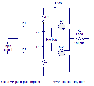

I found this circuit:
So this circuit will provide +- 15 V on the load depending on the input signal, right?
Also I do entirely understand the purpose of C1 and C2 and as a result - have no idea what the capacities of those shall be.

You still do not have an "amplifier" because it does not amplify the signal voltage level. If its input capacitors are calculated to pass thye lowest frequency you want then its output signal level will be slightly less than its input signal level because the transistors are simple "emitter followers" (look it up in Google). Also the output will have a DC voltage that is not suitable for a speaker.
If the input is +- 5V then the output will be +- 4.9V.
The input capacitors pass the AC signal but block the DC "pre bias" from being shorted to ground by the input signal generator.

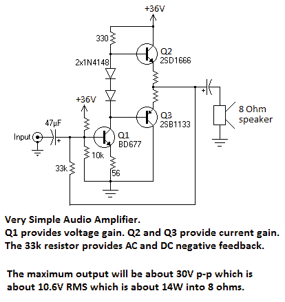

I have never seen an audio amplifier that uses these capacitors. Usually an audio amplifier has its stages DC-coupled.
Here is an audio amplifier that is the most simple:

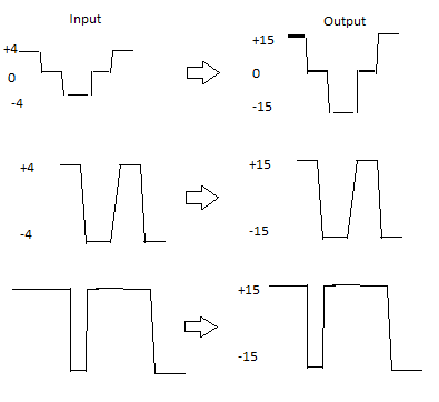

The circuit shall not be used for sound It will be used to drive a magnet with ramp-like steps. The frequency (~4Hz) and the shape of the changes should be defined by function generator.
The following is an example of what function generator will output, and what I want to feed to magnet.
Am I on the totally wrong path then?

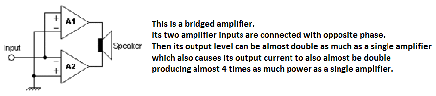

Two emitter followers do not amplify the signal voltage level. Your last circuit has two power supplies, a positive one and a negative one. It has the bases of the transistors without any "pre bias" so their output will have a dead zone of about 1.5V when their input is near 0V. It is called "crossover distortion". Their maximum output voltage levels will be their input voltage levels minus about 1.7V.
Here is the block diagram of a bridged amplifier:
Almost. You probably need to add two more diodes across R1 and R2. These act as "catch" diodes to establish the DC bias on the two coupling capacitors.
P.S. thanks for advice, Audioguru, " Or you can use a bridged amplifier that has two push-pull amplifiers, each powered from the same 14V, each amplifier driving opposite ends of the coil with opposite phases." - how this can be done?
This technique is called BTL - Bridge-Tied Load. If one end of your external load must be tied to GND, this will not work. If both ends of the external load can be floating, then this is a possibility. But since you have a 30 V supply, not explicitly necessary.

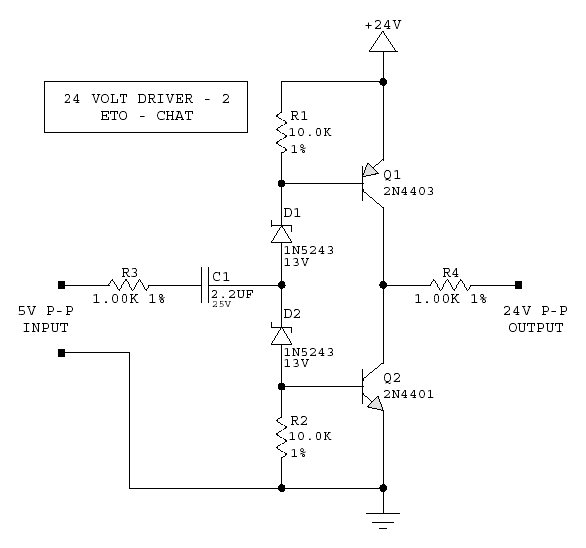

Another thought - You said that the signal being amplified is pulses. If that still is true (no sine or triangle waves), you do not need a linear amplifier. A pulse amplifier is much more simple, and the output transistors are saturated so there is very little heat generated in them. Attached is an updated version of driver I did last year. It can supply 200 mA peak output current by deleting R4. If that is not enough, the two transistors can be changed to power transistors or power darlingtons.

I think the "24V Driver" circuit will cause crossover distortion because both transistors are turned off when the input signal level is less than 1.4V.
Intentionally. It is a pulse translator/driver, not a linear amplifier.

The sketched pulses have noticeabley slow rise and fall times that will be messed up with the crossover distortion.
Thanks a lot for the sketch.
Actually I do not mind some distortion. Also in principle I can change the rise to sharp-ramping, so the input would not be less then the mentioned by audioguru 1.4.
One small request though - could you please adjust the sketch so it would work with 50 V PP output? I am going to order the missing parts, want to make sure I will have everything needed.
I would go for higher current output. So I would appreciate if you could suggest power transistor that would go along with your sketch.
