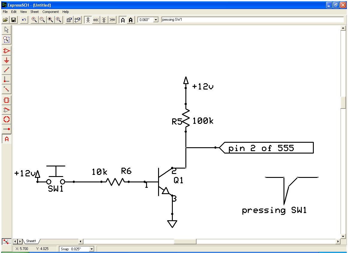

need a low pulse to trigger a 555 timer.
using a 2n2222 transistor to ground
is this correct.
I used a simulation program and it looks good but ??
I have a feeling I need a capacitor??

Your circuit will work if the switch is pressed for a short period of time.
If the switch is kept pressed, the output of the 555 will remain HIGH.
You will get a number of short pulses at pin 2 due to the switch contacts bouncing for a few milliseconds.
These pulses don't matter as the 555 just recognises the first pulse. Or more accurately, the first time the voltage level is below 1/3 of rail voltage.
You do not need the transistor. Except the transistor is inverting the signal.
You will need to place the switch between pin 2 and ground, while keeping the pull-up resistor.
Is the switch totally isolated or does one side go to the 12v line.
Can the position of switch be altered.
the input is 12v
a high signal but the 555 needs a low signal.
with a high signal input at the base the transistor grounds the # 2 pin thus creating a low signal and the 555 progress to do its thing.
Why can't you use a pullup resistor to make pin 2 high then use the switch to ground it and trigger it?
the switch is just a represention
of the 12v input that triggers the 555.
there is a switch but its elsewhere.
I just included it to show that the 12v is not always present.
as long as the transistor switch works
and it produces a low on pin 2 then I am happy.

You have got to answer our questions if you want us to help you, rather than going down your own path.
We asked: Is the switch connected to anything?
This is the first question we need answered.

P.P.S. - As far as the first circuit is concerned, there seems to be little reason for the transistor as many have already noted.
If Rl is 400 ohms and the supply is 14V then the current when the transistor is turned on is (14V - 0.13V)/400 ohms= 43.7mA.
The base voltage is about 0.65V so the base current in the 8k resistor is (14V - 0.65V/8k ohms= 1.67mA. Some of these transistors needs a base current of 4.37mA to saturate.
You are all running around in the wrong circle.
The interface to the 555 requires a high impedance stage and this cannot be worked out until it is known if the switch can be positioned HIGH or LOW.
