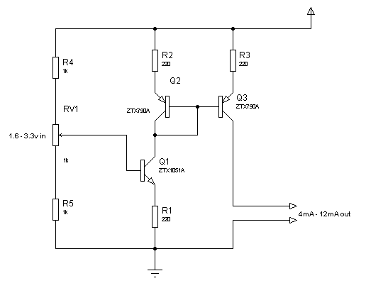

I use three transistors in my current convertor...
