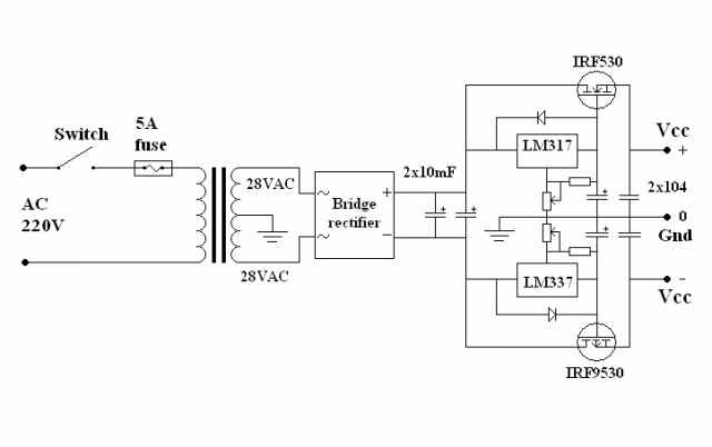

here is my version of supply circuit

Your voltage regulators are not needed for an audio power amplifier. They will not work properly:
1) The Mosfets are source-followers that have a voltage loss of 3V to 6V that changes when their temperature changes and changes when the load current changes. Therefore the output voltage is too low and is not regulated.
2) The output voltages from the Mosfets are not regulated because the Mosfets are not included in the IC circuit, instead the Mosfets are simply hanging on their outputs.

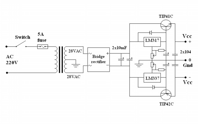

Here is the fix version, use bjt TIP41-42. Main power in my local very unstable if a high power device is switch on, can make "pop" sound in the amp.
Audio power amplifiers usually do not need voltage regulators.
Your new power supply but with bipolar transistor emitter-followers hanging on the output also has poor voltage regulation.
The transistor is usually included in the circuit for excellent voltage regulation like this:

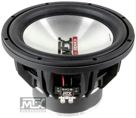

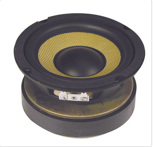

A good speaker that can handle 20w may has diameter 15-25cm? How large is a 40w subwoofer should have?
15-25cm= 6" to 10" in English. The range of base drive units is much greater than that, about 4" to 20", and over for some high power types.
You really ask the wrong question:
In a typical audio signal, most of the power is in the low frequencies, and also cone extension is inversely proportional to frequency (I think that is right). The net result is that the sub chassis has to handle a lot of power and push a lot of air. That's why they tend to be huge, hefty, and heavy. The other thing is that, cone extension, for a given power, is inversely proportional to cone area: the bigger the area the smaller the extension.
In general, speaker distortion is proportional to cone extension which is inversely proportional to cone area. So you may think, why not always have a large cone? The reason is size and cost. But there is more to it than that: the larger the cone, the more difficult it is to keep it moving as an ideal piston.
That is the foundations, but the next subject is frequency response. Ideally, you want a frequency response flat from DC to 200Hz say- it varies. Physics makes this impossible and the speaker will resonate, typically at 10Hz for a very large unit up to 150Hz for a small one. The resonant frequency is proportional to compliance/mass, where mass is the weight of the moving part of the cone and compliance is the overall stiffness of the suspension. Base drivers universally have a two-part suspension with a spider at the centre and a surround at the periphery of the cone where it joins to the speaker frame.
You might ask, why not make the cone heavy and the suspension really compliant to get a resonant frequency as low as you like. As usual in life, you never get something for nothing.
The heavier the cone the less efficient the speaker becomes and the more difficult it is for the suspension to keep the cone moving without wobbling around, generating distortion, and even rubbing the voice coil on the magnet pole.
Those are the basic constraints when designing a sub speaker chassis and there are two broad approaches for realising a good bass response:
