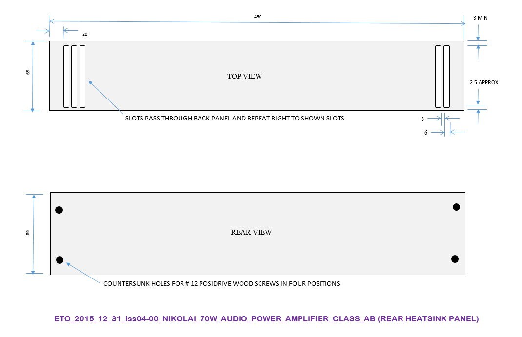

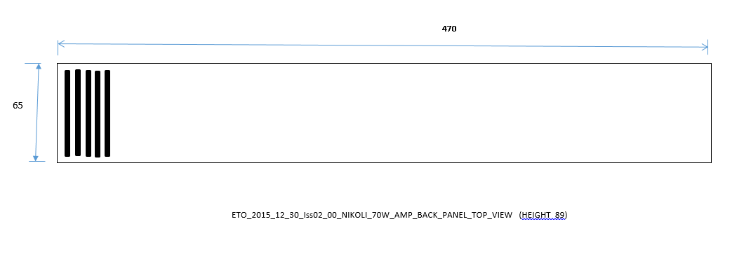

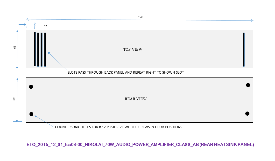

Top view of cast back panel for 70W left, right, and bass sub class AB audio amplifiers. The black shapes are slots going from top to bottom of the rear panel. They repeat horiizontally along the full length of the back panel. Material ally (aluminium or any other high thermal conductivity hard material). All dimensions in mm, unless otherwise stated. Note: amp will be compatable (with slight mods) with industry standard 19 inch racking system (3U high).
ERRATA
(1) Change horizontal dimension from 470 to 450
(2) verticle dimension line on left should be verticle
(3) Nikoli should read Nikolai

I don't understand what is slot and purpose of it?
For heatsink's fins?
The idea of a heatsink is to lose its heat to the air by convection, as in Physics theory. To do this efficiently it needs to present as big as possible surface area to the air with enough free air around the surface to alow the easy flow of convection air currents which go upward. For this reason verticle fins are the best.
The new heatsink design is the same as the first one with the bent ally (aluminium) sheet fins, except the back of the fins, instead of being open, are now closed to make casting simpler and to stregthen the fins which would otherwise tend to crack. The flat back to the fins also looks tidyer. If you could cast the fins 3mm thick and leave about 4mm space betwen them that would be ideal.
The effective back panel should be 2.5 to 3mm thick, but not critical. The effectictive front panel, that the power transistors bolt to, sould be at least 3mm thick.

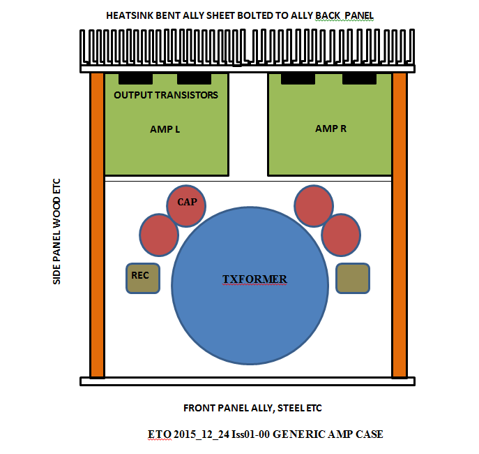

I think power transistors bolt to back panel, but you said front panel, why mount transistors to front panel?
eto_2015_12_24_iss01-00_generic_amp_case-png.96354
My confusing terms; power transistors mount to the front panel of the back panel- I should have used a better term. The arrangement is exactly like in the above image.
The slots are effectively holes. They go through the heatsink from top to bottom to allow air to flow through and cool the 'fins'.
