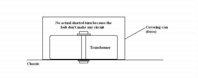

Generally no, especially with a toroid, but you must be careful with positioning the transformer in relation to sensitive electronic circuits. In extreme cases I have wrapped a shorted turn of copper or aluminum sheet around the outside of transformers to reduce hum.
This approach is not unusual in commercial amps, especially pre amps. Don't confuse an external shorted turn with an actual shorted turn, which must be avoided or the transformer will be wrecked. It is very easy to accidentally make an actual shorted turn with a torroid, so watch for this when mounting a toroid. A conductive mounting bolt thru the center of a toroid can cause an actual shorted turn. One case I came across was an amp that was growling: someone had fitted to long a bolt in the center of a toroid and generated a shorted turn. The bolt was quite hot.
No, no shorted turn because my idea like this:
In case the bad idea you talked about: the bolt will be heated by current (so it waste lots of electricity and can blow main fuse). I have solution for that bad idea: don't use metal bolt, I will use a bamboo rod then tap the head with nuts. Or use insulator between bolt-wash and chasis or bracket.

No, no shorted turn because my idea like this: View attachment 96973
I found a website that talk about problem: **broken link removed**
You have a handle on the position. A conductive mounting bolt can be and is used provided it does not form a shorted turn.

The typical Toroid mounting is a Bolt, large metal washer. large rubber washer, torroid, large rubber washer. When mean large I mean HUGE washers.
See: https://toroid.com/Transformer-Products/Mounting-Hardware Mounting washers with rubber pads. That's what I used.

About transformer mounting, my construction: Bolt, shakeproof washer, washer, large ferro plate, cardboard plate, transformer, cardboard plate, chassis, washer, nut.
Why don't use free cardboards, steel sheets around instead of buy from store. Of course the cardboard must be thicker than 2mm.
I will wrap all sides of toroid core with thick cardboard, use masking tape to make it unmovable. Wind primary coil. Wrap cardboard again. Wind secondary coils. Wrap cardboard one more time. Wrap a copper sheet around to prevent magnetism leakage. Wire addition coil to feed preamp, LEDs, fans. Finally cover all transformer with some layers of tape. Done!

You don't want cardboard around the core. Equal spaced windings. You can save time for the primary if you wind it in the Bifilar mode. Hand winding of large toroids can be done with a flat piece of wood with notches. Wind the amount of wire on the stick and then keep passing it through the toroid. Then if you need 240 V, wind as two concentric 120 V windings. i.e.two wires together.
The secondary is done the same way. So for 35 CT, you wind two 35 V windings. Mark the phase.
tape may prove to be very useful especially between the primary and secondary.
The flux of a toroid is for the most part confined, but an electrostatic shield may or may not be required.
