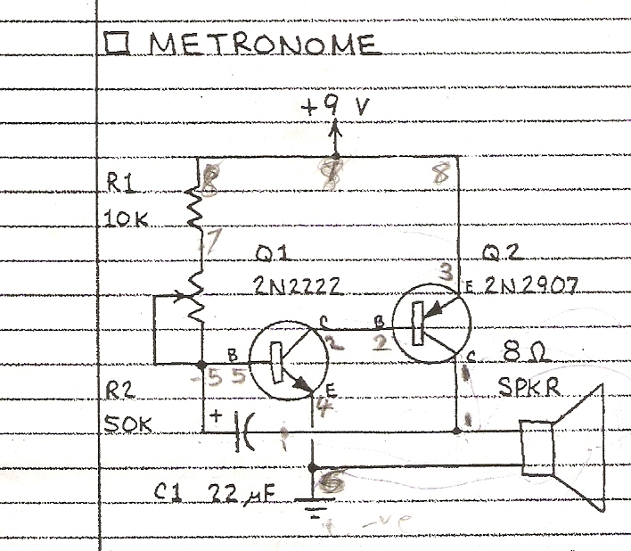

transistor pair and capacitor
kunmycharles
pls can someone please give me a technical explanation about how this circuit works

Techy explanation: When the PNP transistor turns ON, it discharges the capacitor and it turns itself off, so the cycle repeats again.

It's from a Forest Mims book; this circuit is normally repeated a couple of times in each of his books, with different component values and no explanation of how it works.

It's a beautiful oscillator circuit, energy efficient and reliably starting. And 2N2222 and 2902 are hardly 1950's.
The metronome timed period is caused by R1+R2 into C1, when C1 charges to 0.6v Q1 starts to turn on, turning on Q2, its collector voltage risies rapidly which turns on Q1 even harder via positive feedback from C1. The speaker voltage rises close to 9v rail voltage, then when C1 has delivered all its charge into Q1's base there is nothing to keep Q1 on, so everything starts to turn off, C1 again positive feedback making the turnoff quick. Both turn on and off would be very fast.
Timed period is R1+R2 to C1, speaker hi period is very short and fixed, set by psu voltage and C1 value.
The only downside I can see is that the metronome period is very influenced by psu voltage and it will get slower as the 9v battery voltage drops.
