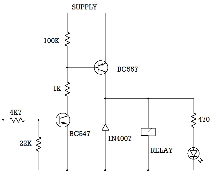

transistor switch help
heres how i would have done it ,but still as far as i can see you have done quite a good job of it so far........omit the relay and drive within reason any inductive load you need -as long as you dont exceed the rating of your transistors used.....
