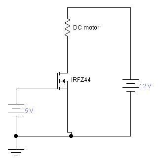

i just connected a simple testing circuit on the breadboard.it is shown below.at first,i thought that the circuit work properly since the motor could run.but when i removed the the 5V power supply from its gate terminal, the motor still running!!!!???? what happen to this circuit?did i connect it wrongly?plz help

The intrinsic gate capacitance will hold a charge for quite a while, holding the MOSFET on. Add a 1k resistor from gate to GND which is always connected. This will discharge the capacitance when you remove the 5 volt supply. You should also connect a 1N4001 (or equivalent) diode across the motor, cathode to +12v. This will protect the MOSFET from the flyback voltage spike that will otherwise occur when the current through the motor's inductance is interrupted by turning off the MOSFET.

Reading from the datasheet, Vgs(thresh) looks like between 2.0V and 4.0V. Presumably, the pic puts out a 5V high signal, so that should be good. The rub, however, has to do with Rds (drain-source resistance), and the Id.
What kind of resistance does the motor have? Rds(on) for the IRFZ44 is very tiny, so it shouldn't matter a whole lot, but it's still a necessary part of the analysis. As long as the motor has a resistance > .25ohm, it should be fine (ohm, not kohm).
The math behind the discharge makes me smile :). As it turns out, a resistor from the gate to ground would have to be... 13.6Mohm for a .1 second discharge. Any smaller value, and the MOSFET should just switch faster. Basically, grab a resistor out of your box that is larger than 10k, and put it there. It'll work fine.
What do you mean that you don't think the mosfet is turning on all the way? Is the motor spinning slower than it would if you hook it up straight to 12V?
This is still bugging me :)
I looked into it a bit more, and it looks like (not quite the same here..) at 25V, and 5Vgs, the mosfet should conduct around 20A. That should be plenty to power your motor, no?
I'm not sure how the curve changes when Vds=12V instead of 25V, but it shouldn't be too different.

True, but turning off (or on) a power MOSFET (or power anything, for that matter) slowly is not a good idea. Peak power is dissipated during the transition time. For the protection of the transistor, this time needs to be short. In power switching, 100 milliseconds is not short.
what i mean is that,if i want to use power mosfet as a switch,i have to drive the power mosfet into ohmic region and bypass the active region.to drive into ohmic region,according to datasheet (and wat i read from a textbook) is that the supply voltage to the gate terminal should be about 10V and this is not enough from microcontroller pin. only when the power mosfet is driven by that voltage,it dissipate less power (since the resistance is near zero and all the voltage is dropped on the load coonected to the drain)then how to let the gate receive about 10V?
i consider to use a transistor to drive it but dont know how?or any other way?
once again, do i need to connected a current limiting resistor in series to the gate terminal?
There are lots of power MOSFETs that will turn on with 5v Vgs. Do a Google search for "logic level mosfet".
