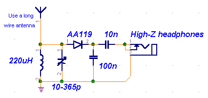

ohhhh...that sounds i'm screwed.. actually i'm new to this field...i was jus asked to make 180khz receiver circuit from my college..
Weren't you taught about super-heterodyne radio circuits?
But for low range then a simple crystal radio child's toy circuit will work.

will this work on 180 khz. what should i change from default given values?
What you have there is a basic crystal radio receiver. That should tune between about 561 KHz and 3.3 MHz as it is drawn I think. The frequency range is determined by the coil (220 uH) and the variable capacitor 10 to 365 pF. The formula is attached. I also suggest you read this page with a focus on parallel RC networks.
Remember this is a very basic crystal radio receiver you posted. Also suggest you start understanding antenna length as was mentioned.
What exactly are you trying to do?
Ron
I'm trying to make a 180 khz receiver circuit. Oh and thanks for that wiki information.I did calculate keeping inductor same. I think i need capacitor of around 3.55 pf
