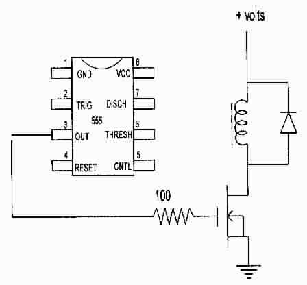

do you think you could show me a schematic of the MOSFET setup? and do i need to drive the mosfet with a transistor, or is it direct from the timer?
The timer can dirve it direct. The 100 ohm resistor acts with the Cgs of the MOSFET to slow down the turn-on time. Too fast turn on can cause excessive current in the internal capacitance. Once you start current flowing in an inductor, it continues to flow even when the MOSFET is off. The diode provides a path for the "flyback" current.
