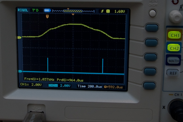

I know this doesn't help any, but the programming really became clear and easy when I was able to look at what was happening with a scope. You are able to change the trigger timing, watch it on the scope and watch how it effects the AC load, in my case Christmas lights. Oddly, the uC I was using was triggering on both rising and falling edge when it should not have been and I still have not figured out why, but I have a workaround.
