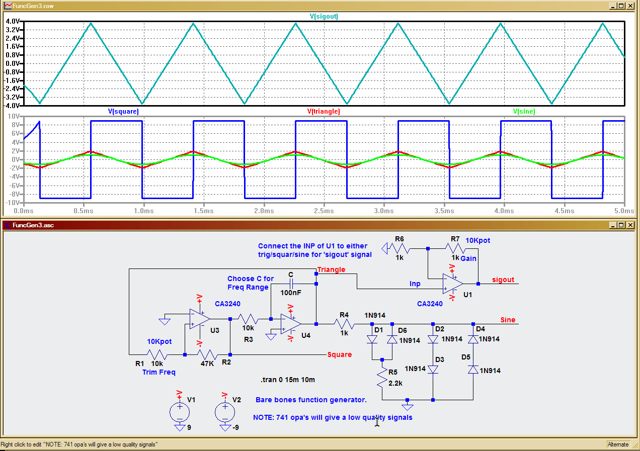

I am trying to build a triangle waveform generator using an lm 741 and this link **broken link removed** as a guide, all i am getting is a square wave out of each oscillator? any ideas?

Hi Michael,
This is a very simple function generator, based on a datasheet example.
I would recommend that you do not use 741 opa's on your projects, they are very old and have a very low specification.

The non-inverting input to the triangle generator opamp is not connected to ground. It's connected to the vairable resistor, which creates a reference for the input. Connecting to ground won't work.

This circuit uses two opamps so it should use a dual opamp.
The LM833 is a good dual opamp that works well up to 100kHz but its minimum supply voltage is 10V. It is low noise.
The MC34072 is also a good dual opamp that works well up to 100kHz. Its minimum supply voltage is only 3V. It is not low noise.

I would suggest CA3240 dual OPA's, they cost less than 50pUK.
They work on single or dual supply voltages and IMO a low cost versatile OPA.

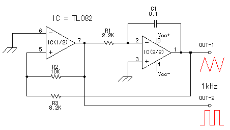

can anyone post schematics of other simple circuits they know will work? Ive been trying a bunch found online with little success.

The circuit you posted works perfectly.
With a positive and negative 9V supply, its square-wave output is about 16V peak-to-peak into a 10k load to ground and its triangle-wave output is about 13V peak-to-peak into a 10k load to ground.
Its outputs can drive a load as low as 1k ohms but then its output levels might drop to half.

I should be able to apply this circuit to any dual op amp correct?
A lousy old LM358 dual opamp has a very poor high frequency response so if it is used in this circuit its square-wave and triangle-wave will have poor wave shapes.

This circuit still does not work properly, I can not generate any waveform using this schematic https://www.electro-tech-online.com/attachments/triangle-wave-oscillator-png.28722/. I fail to see how this is a comparator/integrator circuit. Shouldnt the inverting input of the comparator have a capacitor connected to ground to generator a square wave which would then slightly ramp down through the integrators inverting capacitor generating a triangle wave?
This circuit still does not work properly, I can not generate any waveform using this schematic. I fail to see how this is a comparator/integrator circuit. Shouldnt the inverting input of the comparator have a capacitor connected to ground to generator a square wave which would then slightly ramp down through the integrators inverting capacitor generating a triangle wave? on my oscilloscope there is a very clear upper trigger point, a huge jump.. but no triangle or square wave... just a jump,,, hhhmmmm this is quite frusterating.

it was easier to just make a new one, i couldnt remember my password or what e-mail account i used for the original. anyway I cant get this to work, ive tried so many combo's of a triangle wave oscillator my heads spinning... hhhmmm... could it be the dc power supply? i can get a square wave just fine.. triangle wave.. not even close.
