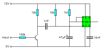

I need to trigger a 555 timer with a positive pulse instead of the negative pulse required. Using a 2N2222 transistor, how can I calculate the base resistor and collector resistor needed? I will have the emitter tied to ground.
A rule of thumb for making a saturated transistor switch is that the base current should be 1/10 of the required collector current. So,.... If your input voltage is the same as your output, the base resistor is 10 times the resistance of the collector resistor.
For your 555 circuit, try a 10K on the base and a 1K on the collector. A 2n3904 or 2n2222 should work fine as will almost any small NPN transistor you might have around.

Don't bother doing any calculations, just use the values in the diagram below.
