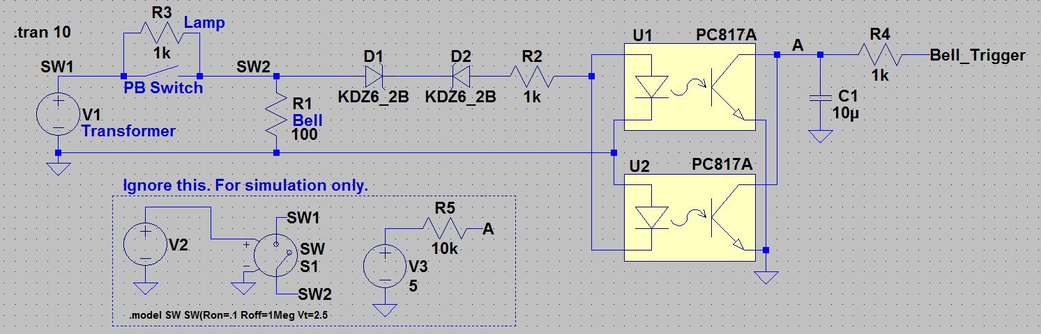

Here is how I would do it.
The problem that the lamp across the doorbell switch causes there to always some voltage across the bell.
The two zener diodes subtract about 7 Volts from the peak voltage that shows up on the doorbell. These values assume that the voltage across the doorbell is less that about 5 volts AC when the button is not pressed.
The values may need to change. The voltage of the zeners needs to be about 1.5 to 2 times the AC voltage measured across the bell when the button is not pressed.
The value of R1 may need to change depending on the final zener voltage is chosen.
The opto coupler can either be the AC input unit you found, or 2 generic opto couplers wired as shown.
Also, be aware that the output of the opto coupler will be pulsing at twice the AC line frequency. C1 should flatten those pulses out, but it's difficult to choose a value without knowing what the front end circuitry of the video doorbell lokks like.

Never heard of those zener diodes but seems to my understanding that they have a minimum current limit that when reached will all current to pass so I simply need to find out what is the minimum current. Do you know how to find out using a mulitmeter?

Zener diodes are voltage and polarity dependent devices. When they are forward biased, they act like a regular silicone diode with a forward voltage of about 0.6V. When reverse biased, and the voltage across the diode is less than the zener voltage, they are nominally open circuit. When the reverse voltage exceeds the zener voltage, they start to conduct. You do need limit the current through the zener to make sure that the total power dissipation is less than the power rating of the zener.
The reason that two end to end zeners are needed in this circuit, is because the applied voltage is AC. In my circuit, the effective AC zener voltage is the forward voltage (~0.6V) plus the reverse voltage (6.2V).

Then you can use lower voltage zeners. There is a slight advantage to using a lower voltage zener. The width of the pulse on the output of the opto will be a bit wider with a lower zener voltage. That may, or may not, make any difference to your video doorbell input.
The 1N5221B is a 2.4 volt part, and is the lowest value in that family. Here is a possible source:
https://www.digikey.com/product-detail/en/on-semiconductor/1N5223B/1N5223B-ND/977556
The voltage at the bell when the button is pressed will be a bit lower than the transformer output. (lower due to wire resistance)
At 21VAC the LED current with 1K for R2 will be about 17mA. The average dissipation, when on, is about 0.3 watts, so use at least a 1/2 watt part there.
