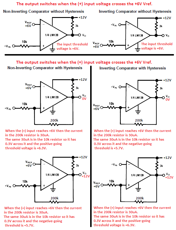

Hysteresis just means that the rising trip point and the falling trip point are different. I have never heard of different types of hysteresis having names.
Hysteresis in a v-com or an op-amp is most simply accomplished with positive feedback with a resistor from the output to the non-inverting input. Basically you are changing the reference voltage at the non-inverting input so that the voltage at the inverting input needs to be at a different level to trip. It is possible to do positive feedback to the inverting input if you have some other circuit element that does a state inversion.

Hysteresis is made by adding a little positive feedback. Then the input must swing a little more than the reference voltage.
I copied a lot of this diagram from the datasheet of the LM339 quad comparator IC:
