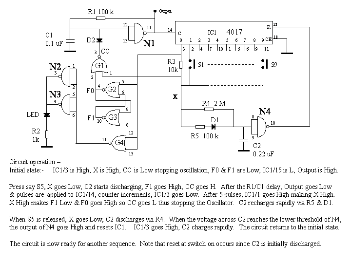

i am having some serious trouble with my design. i am trying to get a 4017 to count 4 inputs, (q7-q15) and then trigger(q2) a 555(on the reset of the 4017 so i get the (-)edge) set up for 20-25s(2200uF and 10k) ouput (q3). i am using a 5vdc regulator for the 555 (q8 pos-q1 gnd) and for the 4017 (q8 pos -q16 gnd). i can get the 555 set up to trigger when i connect pin 2 from vcc to gnd and i can get the 4017 to count and reset. i cannot get the two to play together. any suggestions?
I have a suggestion, make and post an accurate, well constructed schematic of your circuit. That's how we communicate our ideas on this forum. You're probaly not going to get much of a response until you do.
sorry, dont have a schematic software. will try and find something. was hoping ppl here would know what i was talking about.
You could draw it on paper and post a scan.
If you don't have a scanner, you could download a programme such as Circuit Maker.
Alternatively, use PowerPoint, MS Paint or other drawing package.
Attached is an example (when helping someone else on this forum) I did using PowerPoint.
I save it initially as a .ppt then, when ready, save as a .gif and post.
The point is that we are all busy people and we don't have the time to unscramble your verbal description.
Besides, a picture is worth a 1000 words.

An ordinary 555 has a very high output current that causes a 400mA spike on its power line. The spike upsets the CD4017 counter.
Two bypass capacitors are recommended on the datasheet of the LM555 to reduce the spike.
You should use a Cmos oscillator made with Cmos inverters or gates or use a Cmos 555 since the counter is Cmos.
