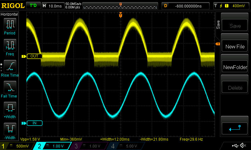

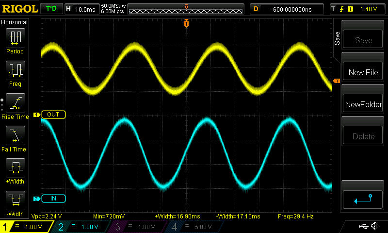

here's shots to perhaps explain situation better
so only difference in circuit is that i swapped resistor and capacitor in between
LPF, works as intented, no clip at any frequency i tested
HPF, with clip, with any frequency

I am guessing that the input voltage has a positive offset and in lpf case the + input gets bias from this offset and in hpf the + input is connected to 0V.
there's nothing more to show in schematics,only biasing i've made is in input, function generator is offset so there is no negative signal at all going in opamp. so yes, input voltage has positive offset
hmm, i must use/make split supply even if lm358 is single supply? so there's then +-12v and ground, like putting batteries in series i get that far, but since this opamp won't like negative voltage, what does that negative 12v do? bit confusing for me.....
well i'll be, made that virtual ground and it did the trick, cutoff gone. Now, i just dont understand, why and how?
But, i tested it with low-pass, and it does that clipping there with virtual ground being used?
But with hpf there is no positive offset to + input of the opamp because the input capacitor cuts it and you have input voltage that is between
+Vinpeak -Vinpeak
Ah, of course! btw, i used virtual ground as input ground, like where i ground either resistor or capacitor, i suppose i did that right?
