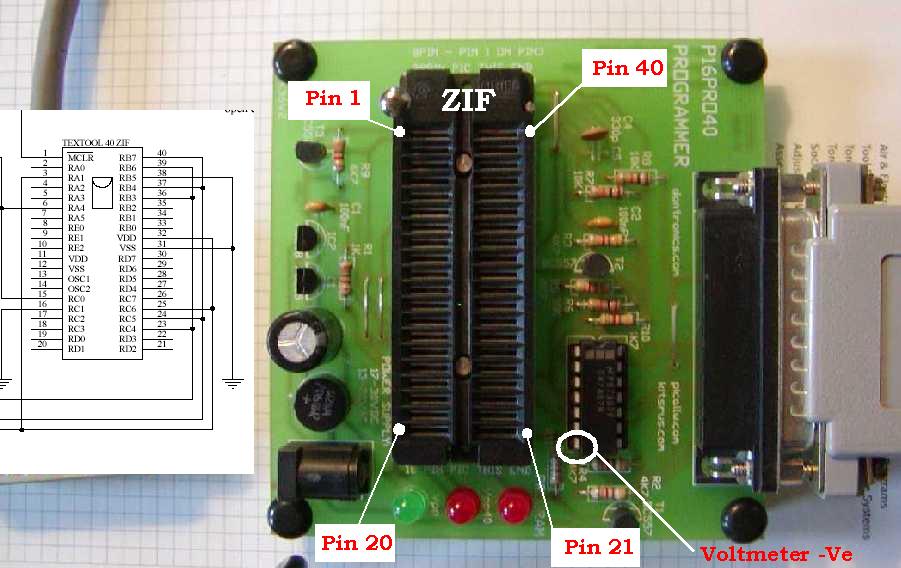

I just assembled a P16PRO40 programmer from Amazon electronics, and I am having trouble programming a PIC 16F628. I have never successfully used this programmer before, this being my first PIC project. I am supplying it with 17 vac from an unregulated wall wart. I am using WinPicProg, with the settings for a P16PRO40 - 7407. I get the error message " Verify failed at Program address 0x000, Programming Aborted." I have already checked VPP, and it reads as 13.1 vdc. I am new to this, and not sure what to check now. Any ideas?

You've got it configured incorrectly, in WinPicProg there are two fixed settings for the P16PRO40 (7406 and 7407), depending which buffer IC is fitted (one inverts, one doesn't) - either select the other P16PRO40 setting, or the custom setting and set them your self.
My buffer appears to invert, so I would choose the 7406, right? That's how I have it set up currently. I have verified that the signals reach the socket ok, the appropriate pins ( at least as far as I know) are driven high when the outputs are on. I tried sanding the pins of the chip, and still have the same issue.

The pin numbers does not make sense to me. You have to be careful in counting the pin number. You have not told us which PIC your are trying to use in the last test.
Let start again, hopefully with some good result. The correct choice for your 74LS05 is option "7406" inside the WinPicProg software.
1. Look at the bottom right of the following image. The #7 pin on the 74LS05 is where you connect the -Ve of your meter for all voltage measurements.
Now all the following pins refer to the 40-pin ZIF socket:
2. Do your test again, without a PIC in the big ZIF socket, measure the voltages on:
Pin 1, 3, 6, 16, 23, 24, 25
It would be best to present the results using a table to show different voltages when different action performs by the WinPicPro software. If WinPicProg has hardware check function, do a check and measure a set of results.
Do you know you have to place different PICs into different locations of the ZIF socket? Just checking. I steal the picture from a thread to help you out and I hope the owner wouldn't mind.

Thanks for the additional info. I was using a 16F628 in the previous test. I was placing it with it's pin 1 in pin 12 of the 40 pin socket, as indicated by the sheet I got with the programmer.
Pin 1 - 13V when Vpp40 is on
Pin 3 - 5v when Vdd on
Pin 6 - 13v when Vpp is on
Pin 16 - nothing, save continuity to ground
Pin 23 - high when clock is high
Pin 24 - high when output is high
Pin 25 - 5v when vdd is on
And just to clarify, is this list correct about how to insert the PICs?
40 pin PIC : pin 1 on pin 1 of socket
8 pin PIC : pin 1 on pin 3 of socket
28 pin PIC : pin 1 on pin 1 of socket
18 pin PIC : pin 1 on pin 12 of socket
