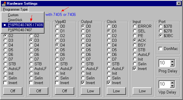

Ok, if I'm reading my meter right, the buffer IC is fine, and acting as it should. The issue with the clock and data ports was solved by setting it to 7406, and then to custom, and unchecking the Invert boxes under data and clock. The data and clock are now active when the corresponding input is low. However, I still can't program a chip, it gives me the same error.
samcheetah said:
if you have a P16PRO with a 7406 then you shouldnt choose any option other than 7406. you dont need to select the custom settings because the hardware isnt custom made, it is a standard P16PRO with a 7406.
have you tried a different PC????
The chip is a 7405, which confused me slightly when choosing the options in software. However, the chip appears to function as an inverter, when tested separately from the board, and wasn't functioning in the circuit, I believe because two of its inputs were inverted to begin with. It doesn't program a chip on either setting though. I haven't tried it on another PC yet, but I might later tonight, if I can find one with a copy of Windows installed.
The schematic link on P16Pro40 from Nigel's site also use a 74LS05. So I think it would be a good idea to include 74LS05 as a choice in the "hardware/programmer type" pull down menu. But it is up to the designer. So notices the image title as "wish.gif".
OK - I've updated my current working version :p
Thanks Nigel.

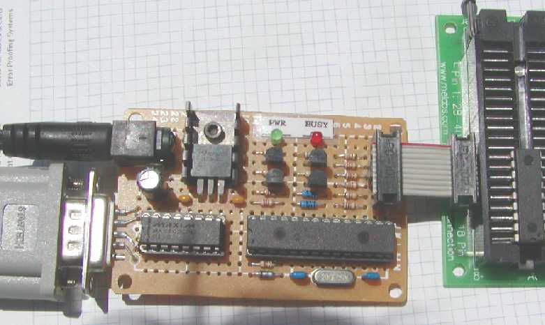

Does anyone have experience with the ICD2 clones sold on ebay and similar places? I'm about sick and tired of wasting time with these $%#@$% parallel/serial programmers.
I'm not familiar with the eBay clones but I built one on a 2 inch by 3 inch Radio Shack prototype board using a slightly modified circuit from the stolz.de.be web page and it works very well... Total cost: approximately $15 USD...
If anyone finds a printed circuit board, please let me know? This would be a very nice half-hour project with a nice PCB... As it is, it took me nearly four hours assembly time spread out over several days to build it with point-to-point wiring (#30 kynar wire) on this proto' board...
Good luck... Regards, Mike
