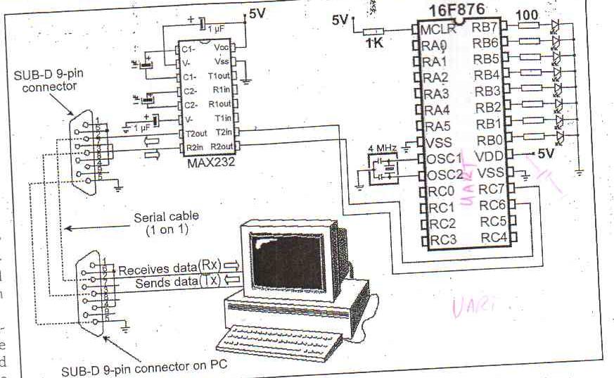

Hi there my name is Bojan and I'm trying to establish PIC to PC communication for a school project. Yet when I ask my teacher for help i get nothing. So I'm on my own and I've tried to figure this out for about two months now. I'm following a tutorial written by Chuck Hellebuyck "Getting Started with PICs."... i have my circuit breadboarded as seen in the attached file. I attempted using picbasic pro as was outlined in the tutorial but absolutely nothing happened. My teacher then told me to use mikrobasic.. So i tried reading the help files and this is what code i came up with :

How are you communicating with this code? If you are using Hyperterminal then you should have it set to 9600,N,8,1 and flow control set to NONE.
Your using the software UART even though the 876 has a hardware one. Microelectronica supply the following example of using the hardware module,

P.S. the other thing that could be wrong is the cable. You may have a null modem cable instead of a straight through cable. If this is the case then the circuit can be slightly modified to get it working.
I think that in the data sheet i found that RB7 is receive and RB6 is transmit, I think:S so I hooked everything up according to that but I still cant get it to work:S. Just a random question in the schematic for my breadboard why are the pins 1,6,and 4 on the serial cable supposed to be connected together. And another weird thing is that whenver i open hyperterminal it connects to COM1, but it wont let me type anything...so I always resort to using the USART terminal that is provided with mikrobasic. I Also tried using your code and I still cant manage to get it to work.

Do you have a MAX232 line driver, or equivalent, connected between the PIC pins 6 & 7 and the PC' serial port??
The reason why some pins are linked on the 9way 'D' is because the PC program is testing the state of these pins, to see if it needs to have TX or RX communication with the remote device.
The PC program can be written so it dosn't test the pins, then you just require
TXD/RXD and ground wires.
