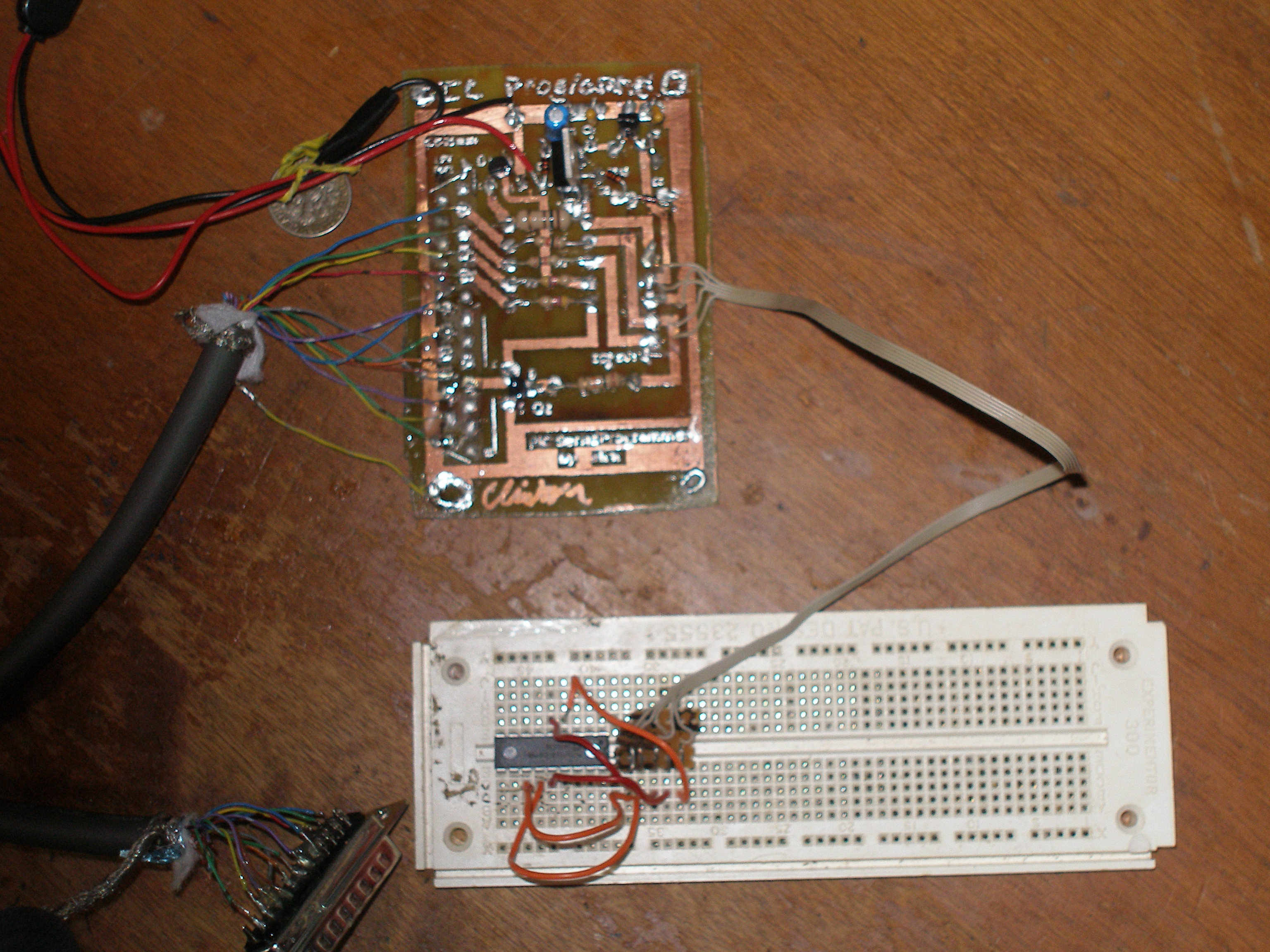

Ok, I have had a rough time (as everyone else it seems) trying to program PIC16F84a 20MHz microcontroller. I have tried many types of serial designs with all kinds of software (except the dos ones) with no luck. However that was using voltage from the port itself and not an external powersupply wich may work.
So I decided to try the parallel port. I built an in-circuit parallel programmer based on the "par-pic" design (if you dont know use google). The only difference is I modified the artwork and added a power supply using a 7805 and 7812 regulator for the 5V and 13V from 18V of batt power. Below is a photo of the finished programmer.

I can't get this programmer to work with any of the traditional software. I have heard windows xp has issues with the lpt port, should I try it in dos? It'll of course read but it wont program. Most software wont even recognize that there is a programmer there. Is it a hardware problem or software?
Also, the original schematic used BC547 transistors, I used BC548, could that cause a problem?

XP works fine with PIC programmers via the parallel port, one cause of concern is the long length of wire from programmer to chip, and the fact you have the chip in a breadboard. These both add extra capacitance, and most parallel port programmers (and serial ones) require very low capacitance to work - this is because they normally use resistor pullups, and the capacitance slows the rise time.

Well, the programmer listed here (**broken link removed**) uses the same type of interface on a breadboard and they make no mention of any problems due to capacitance. If it is indeed that, what are some ways to combat it? Could the length of cable from port to programmer? Its sheilded and grounded and everything.

Oh ok I see what you mean, the dirty connections of the breedboard causes capacitance that affects rise/fall time with the resistors on the board. Well, I dont have any type of circuit built for the PIC yet so I cannot hardwire it. I can maybe solder a socket to a peice of protoboard, and then solder the programming header to the protoboard and place the PIC in the socket.

Maybe I shouldnt have added the power supply to this. I might cut those traces and wire up a resistor and zener like in the original schematic. Also, I noticed the original par-pic does not supply +5V to the Vdd, just the 13V MCLR. Do you need both Vdd and MCLR when programming? Or do you just need the 13V MCLR?
Also, in my board the 12V regulator seems to get quite warm. One time I tested it it got so hot it burned the **** out of my finger and some laquer that got sprayed on it began to smoke. I quickly disconnected it.

The PIC MCLR needs about 11V to put a PIC into program mode, GND will reset it and 5V will allow it to run.

Look again, you need both, and par-pic supplies both.
If the regulator is getting hot like that you've done something seriously wrong, it should run cool.

For a start connect it up properly, if you don't connect 5V it can't possibly work.
Well no kidding? I had the 5V connected from the start I'm not that stupid. I was just asking if it was needed since the original parpic only supplied the 13V, but I see that the circuit was meant to supply the 5V. I just modified the parpic with a 7805 to supply it without it being "in-circuit".
