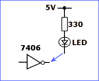

Is there a possibility that I could've wrecked the buffer somehow? I was reading someone's page on the p16pro40 on the net and they said not to turn the computer off with the programmer on. I've done that numerous times.

You can test the 7406 easily. Remove the TTL IC from the existing circuit and place it on an unpopulated part of breadboard.
Power up 7406 and connect the LED to the output of each buffer. The LED should light up.
Short the input of the buffer to 0V. The LED should go off. The buffer is then good.
Test all six buffers. the pinouts are in the datasheet.
