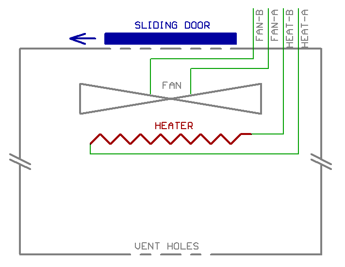

I think that the problem is the two vent holes in the box that keep the oxygen level high and co2 levels down. I was thinking of a circuit using a o2 sensor that would turn on a air pump to inject fresh air through the heat element. What do you think about that one?
Measuring CO2 will be some kind of extravagant.
All you need is a set of holes behind the fan (which is required for equal air distribution anyway) and put a sliding door over the holes to regulate fresh air.
Drill some vent holes near the bottom of the incubator box to force excessive air (overpressure in the box) out where it is supposed bo be cooler than the heated air in the upper region.
About like this:
Boncuk
