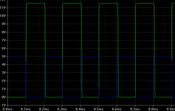

If you decide to use a low side switch the PWM output will be
the opposite of what you want to achieve, the wider the pulse
the lower the power supplied to the load.

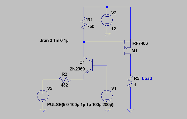

In case you have a transistor and two resistors on hand you
could give this a try.
on1aag.

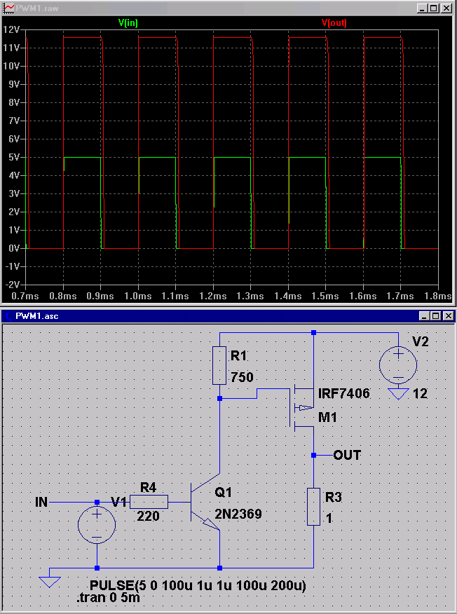

Hi on1agg,
Is there a reason why this circuit(which maintains the PWM pulse duty cycle) can't work satisfactorily?

Hi EBLC1388,
Your circuit should work equally well, although the base current
of the 2N2369 is a little bit high. (I would increase the value
of R4 to 2k7.) But I already uploaded circuits similar to yours:
https://www.electro-tech-online.com/threads/adding-a-component-to-a-simple-2n7000-circuit.42489/
And . . . I noticed that Rube Goldberg was sniffing around so I
gave it a little twist. :D
on1aag.
You would need to invert the input, relative to the circuit you posted. I believe this could be done quite simply with 13 NPNs, 2 PNPs, a unijunction transistor, a couple of varicaps, and a beam power pentode. Oh, yeah, and a hand full of resistors and capacitors and zeners and LEDs and...
EDIT: I forgot the ball of twine, some pulleys, a BB gun, and a water balloon.
Hi Ron,
You're right, the inversion of the signal was the reason for
the twist in the circuit. It was already 4.27 a.m. when I
posted the reply.
