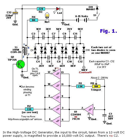

I am somewhat new to all of this and i am trying to find a transformer(T1) that would work in the schematic below. I am well aware of the dangers of this project.
Here is a link to where the schematic came from:
