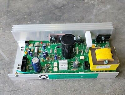

I am trying to fix a Nordic Track C2255 controller board. Anyone knows where I can get a schematic diagram for this board? Or any recommendation where I can get a replacement board without too much cost? Thank you.

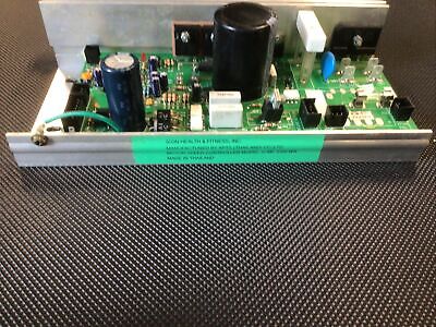

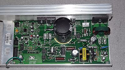

There is some info on here, plus some spares:
And this appears to be the same board as the spare they list, with the addition of a transformer; I'd guess yours has a separate transormer, or is set up for a different voltage?
Another one, the same as yours?
This is the board I currently have. The model of the Treadmill is NTL07806.2. Thank you everyone who responded. I appreciate your help. Thank you.

The photo is too blurry to make out any real details, but it appears toe be the same general series as the ones I linked to, if not absolutely identical.
What model numbers or other info are on the board itself (or its heatsink)?
I think?? the blurry number in the middle is MC2100LS; this appears to match yours??
Or here, this listing also gives a bit of error diagnostic information:
And a set of PDFs including various data and schematics in a thread on AAC, here:-
