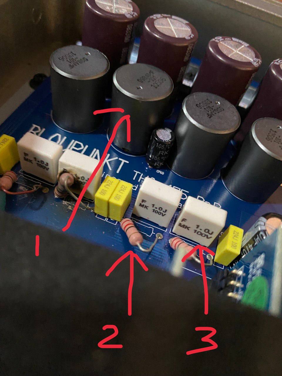

Hello all, I am new here and not good with electronics and have been trying to identify the three components with the numbered red arrows (1,2&3) as well as their values.
1) ? (It says 998AMF-101 10506)
2) Through hole resistor 22R 1W 5%
3) ?
Please correct me if I am wrong and appreciate your guidance with number 1 & 3. Hope to get a reply.
Thank you!
Dion

1) is an inductor. likely 100uH with that "101" designation. Those seldom fail.
2) is 22 ohm, 1W resistor with 5% tolerance, assuming the third band is black. If the third band is brown, it is a 220 ohm resistor. Hard to tell from the picture
3) is a 1uF capacitor rated at 100V
Thanks guys for the prompt replies, yes the third band is black for the resistor. For 1) the housing of the one with the arrow is loose. I’ll have to try and test if it’s good or bad.
Also, may I know what does the number 10506 mean?
This looks like the output filtering on a class-D amplifier? - as suggested, the inductors don't fail - if the core is loose, just glue it (super glue works really well on ferrite).
There's pretty well nothing there which does fail - if you've got a fault, it's VERY, VERY, VERY unlikely to be found in that part of the circuit. What I would do, is bend that blackened resistor away from the capacitor, like the other ones - but both are probably OK anyway.
I would suggest you don't bother trying to test the inductor - the chances of it been faulty are pretty well zero, and the chances of you breaking it are probably well in double figures!.
What's wrong with it anyway?, and why are you suspecting these parts?.
That number may be a house number, batch number, production run, or some date code. In cases where the inductor is a commercially available product, it could be the part number for that manufacturer.

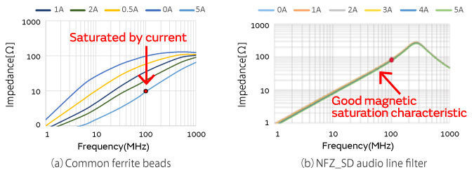

And the Murata website that contrasts their NFZ-SD audio line filters against common ferrite beads as:

Yes it’s a class D amp. It started off with popping and crackling noise from the speakers so I disconnected the amp. When I tried reconnecting the power supply to the amp, it powers on for a split second before shutting off.
Okay noted that the inductor shouldn’t be bad. The blackened resistor doesn’t have any resistance on the multimeter. The burnt capacitor together with it shows a low reading of 0.2uF. The other three pairs of resistors and capacitors are showing the correct reading when tested hence the suspicion of those parts.
2. looks like brown red black which would be 12Ω.
I would presume they are the zobel network?, so 12 ohm is quite feasible - the resistor and capacitor values aren't at all critical - interestingly I had to repair a bass combo that 'blew up' while my daughter was playing it (at a music session for teens - originally for young offenders, run by the Police, but later opened to the general public - my daughter met some interesting people there :D ).
Anyway, the 'blow up' wasn't bad - the zobel capacitor had exploded, because (rather stupidly) it was an electrolytic, and the amp still worked. I was going to simply stick a 0.1uF in (my 'goto' value for zobel capacitors), but as it was a Carlsboro amp (which were manufacturered only a few miles from me, I thought I'd give them a ring. Nice friendly people, they put me through to the right department, and the engineer explained that they used various different values (including some electrolytics) during different production runs, and he wasn't really sure why?. So I stuck my 0.1uF in, as that was a value commonly used in various of the production runs.
As for the resistor value, again it's not at all critical - and I follow the usual technique of using one similar to the speaker imedance - so 8.2 ohm for an 8 ohm amp, or 4.7 ohm for a 4 ohm amp.
I would suspect the output stage (probably an IC?) has probably died - and that's caused the issue.
However, for a start I would very carefully (so as not to damage either components or PCB) remove the discoloured resistor and capacitor and test them out of circuit. Assuming they still test faulty, then try replacing them - but I'm dubious it will cure your problem?.
You could even try connecting an old speaker to it, with those components still removed - it should still work relatively normally without them (some cheap class-D circuits don't even have output filters, relying on the speaker inductance to do the job).
However, as it's shutting down now - see if it still does it with those two components removed - although neither is likely to cause a shutdown (as I said above, it's most likely the amp blown).
