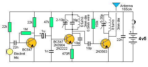

it works even with a 15 pf cap, but the range of the transmitter is very low (only 10M!).i used a 2n3904 and all the resistors which i used in this project are SMDs , has anyone ever made a 1Km transmitter? It's hard like hell to make a transmitter
I used colin's transmitters
and changed component values as:
Supply volt - 3.7V
10p feedback cap changed to 5p (written only "5" on the cap)
470R emitter resist. Changed to 100R
used only 47K instead of 150K for final stage transistor
.did not add 5-30p cap in final stage and used only a 7turn 0.3mm inductor, 3mm dia
bc547 is used as mic amp and two 2N3904
did not use +1u cap, instead i used a poly cap (a green, sack like cap written 223 on it)
Used 1mm thick copper wire to make L1 6turn coil
Result:
stability is not bad, but the range is only 10M!
The transmitter won't work when i added the last 2n3904 transistor (3rd transistor) so i tested the transistor without 3rd 2n3904,
Hope, collin can understand the mistakes i made,

You have to read ALL the pages on RF transmitter on my site to save yourself making all the mistakes you have made.
You need 10p for 3v
100R too low. You are over-driving the transistor.
The final stage is TUNED. You have to tune it
2N3904 cannot be used for RF stage. It has no gain at 100MHz. It is only a 250MHz transistor
The circuit will transmit 27km from the top of a mountain as stated by one of my customers.

thanks collin, so what is the replacement transistor for 2n3563?
I had built the same circuit about 1 year ago, but i disassembled it later and forgot how i made it and what replacements i have made,
try to use 2N3866 locally available . but biasing would change. please check pinout while mounting
