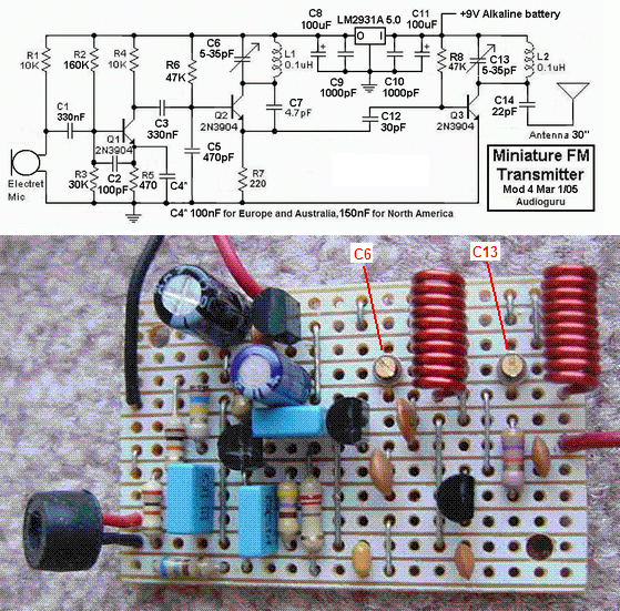

as i suggested in my pm, i openly advise you to use the AG's Mod4 version of FM TX and it works. i had even made a small pcb for it.
we can enclose it is a small metal can. AG has tested it for almost few Km. If the terrain is open unlike concrete jungle of cities, it covers a longer distance even. It is a question of optimising antenna impedance to get a good VSWR
regarding 2N3866, such high power might land you into troubles from government. so, better don't use unless say for a short time like few minutes of testing.

This design also works(see post #17) and its stability is perfect, but the only problem i am having is its range is only a few Meters, (16M max), i don't want to use a high power transmitter due to it's illegal so i just want to build one and test it and show it to my friends as they'r challenging me that "You can't build such a high power RF transmitter!" its a bet infact!, a 1KM version would be enough for me as i just want to prove them that it is possible by me!
Btw, can anyone post AG's MOD4 transmitter for me?
here it is
it's a horrible circuit!!

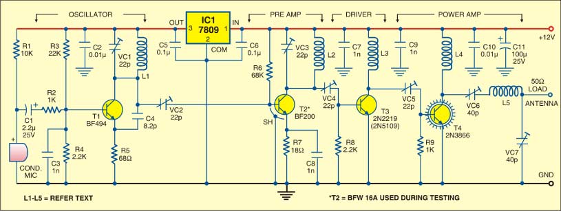

Why are there lots of components in that circuit? And hey i found another circuit from EFY! Please check it out if it is better than AG's i will go with it or i will build Ag's as it looks like a standard one

even if you count, the additional components are not many. if you love to make different circuits that may trouble you like what you already enjoyed( a low coverage), Fine. best of luck.
Long range satisfaction guaranteed if you can successfully implement this circuit and is way too complicated than AG's one.
Let me know if you can grab the transistors/components exactly specified in the circuit. RF assembling is an art that you need careful 'layouting' to get maximum out of it.
The new circuit you found uses very old parts that are not made anymore. It has a high output power that will probably cause interference to radios, TVs, aircraft communications, police and fire department communications and will get you into trouble.

Ziddik, i don't feel that you need that much power by one 2N2219 and finally by 2N3866. I fear, this experiment at that power might risk you legally. Better confine with lower output power, and derive efficiency by optimizing the antenna.
Advantage of LM2931is that, until the supply comes to 5.6V or so, you get 5v output. LM2931 should not be difficult to get. otherwise you might also get smd like LM1117-5. Request some friend to get one from Kochi where you are sure to get it. if you are sure that the input supply is 9v OR ATLEAST 7.5v ABOVE, YOU CAN USE 7805.
As far possible don't use adopter for this experiment as you can't control the power hum.
there is a sequence of optimization of final transistor tank circuit.
if the tank circuit is tuned properly and the antenna is coupled through a small cap like 10pF or some such as indicated in AG's circuit, the RF won't be transferred efficiently. This is the very reason you are not getting the range.
it needs methodical approach. you need to have patience and skill to optimize the antenna matching and tank circuit optimizing.
please try to understand and dont risk yourself with too high powers
I used the LM2931 low-dropout 5V regulator because it still regulates when the 9V drops to 5.6V. You can use a 78L05 ordinary little 5V regulator but it stops regulating (it drops out) when the battery is still fairly new at 7.5V.
There tens of thousands of this low-dropout regulator stocked at the two largest electronic parts distributors in North America.
There are many other low-dropout 5V regulators made by most semiconductor manufacturers.
My antenna is a quarter wavelength at 80cm long. It hanged vertically so it was parallel to the whip antenna on my home stereo and on my car. Colin's antenna is double the length which is not correct for a single piece of wire. Rabbit ear antennas are double the length of mine because they have two ears and are directional.
