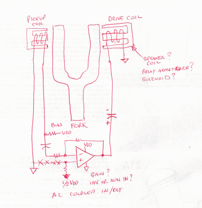

Dear all,
I'm a visual artist (never studied electronics but can read a circuit diagram and do build stuff) and I work also lot with sound. I'm making a work that uses 2 tuning forks with mirrors on the tines. As the forks vibrate a laser beam reflects off the mirrors and projects lisajous patterns. I have been having problems driving the forks in a reliable way. I used a simple buzzer type circuit before but the contacts burn out over time, then I came across the idea of doing it with 2 coils: a drive and pick up type arrangement using a driver and an amp so the electronics put the forks into self-oscillation. I'm struggling to find an overall solution and a simple circuit that will do this and would welcome any suggestions. The forks are about 20cm tall.
Thanks in advance for any advice.
Best Nick
To turn the fork into an oscillator, you need five things: the fork itself, a sensor to convert the instantaneous position of one of the tines into an electrical signal, a power supply, an amplifier, and finally a method of using an electrical signal to impart movement back into the tines...
Seems like you can take these one at a time.
1. Is the fork made of a ferrous material which will interact with a magnetic field?
If yes, then reluctance based sensing would work. So would a solenoid drive system.
If no, then the sensing could be optical (use the laser directly), acoustic (use an electret mic), capacitive (make the tine one plate of a parallel plate capacitor)...
Driving the tine could be acoustic, ...

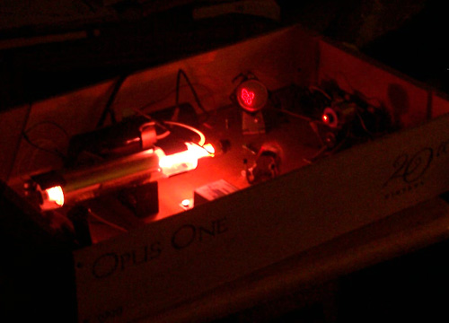

If you want to make cool patterns with lasers. You should use motors and silver backed mirrors. I did one such project. See images

In past experiments I used two 64 hz forks and silver plated mirror and got a nice big laser projection of a circle. I was looking at Lissajous' original experiements with tuning forks and attempting replication. I used a solenoid and a wire contact for the self oscillation switching - great to experiment with but not reliable enough to last for a few weeks in a gallery. I like Mr RBs 555 idea, seems the most stable and I like the idea of some variation in the self oscillatiion by having an open loop. I've never worked with 555s before. I'll look for some schematics. What would the system require?

BTY the forks are ferrous metal.
Ok, something like this? Pick up coil biased to create a magnetic field. Could be one of those old suction-cup magnetic pickups used to record telephone conversations, or a sensitive relay with the clapper removed. Driver coil= old speaker driver, headphone driver, relay/solenoid coil with clapper/plunger removed. Amp inverting, reverse polarity of either driver coil or pick-up coil to get positive feedback. Gain TBD, depends on air gaps, number of turns in the coils, etc.
Q of the fork is likely to be several hundred to even a thousand. This means that if you are trying to excite it with a free-running oscillator like the 555 that was suggested, then the freq of the oscillator would have to be very close to the natural frequency of the fork. Likely, a 555 wouldn't be stable enough unless there is some feedback to the timing network to create an "injection-locked-oscillator". In that case, you might just as well make an oscillator out of it so that it runs exactly at the resonant peak of the fork...

Nice drawing Mike, how did you digitize your etch a sketch? hehe nice idea bye the way. :)
If you could rigidly affix a short iron rod to the top of the tuning fork .... you would have a larger coupling coefficient between the vibration of the fork end and the coil ..... That is, making the coil an air core with the oscillating iron core internal to it .... Do the same for both pick-up coil and drive coil.
