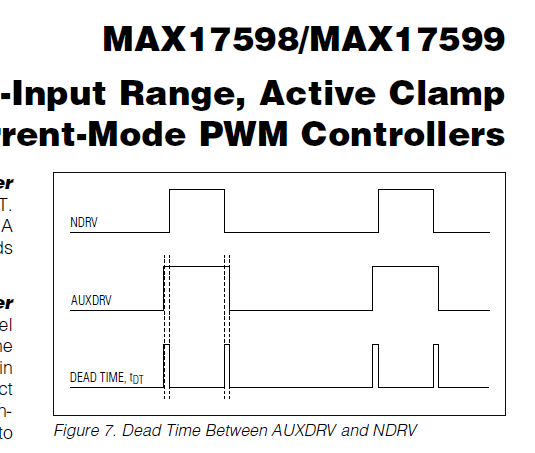

See waveform on data sheet. I think both MOSFETs are on at the same time.

I know it is a different IC. Gate drive waveform. Both FETs are on at the same time.
Note: one of the FETs is a P and so the (actual) gate waveform is inverted from the picture.
Some waveforms in this one. (two) (three)

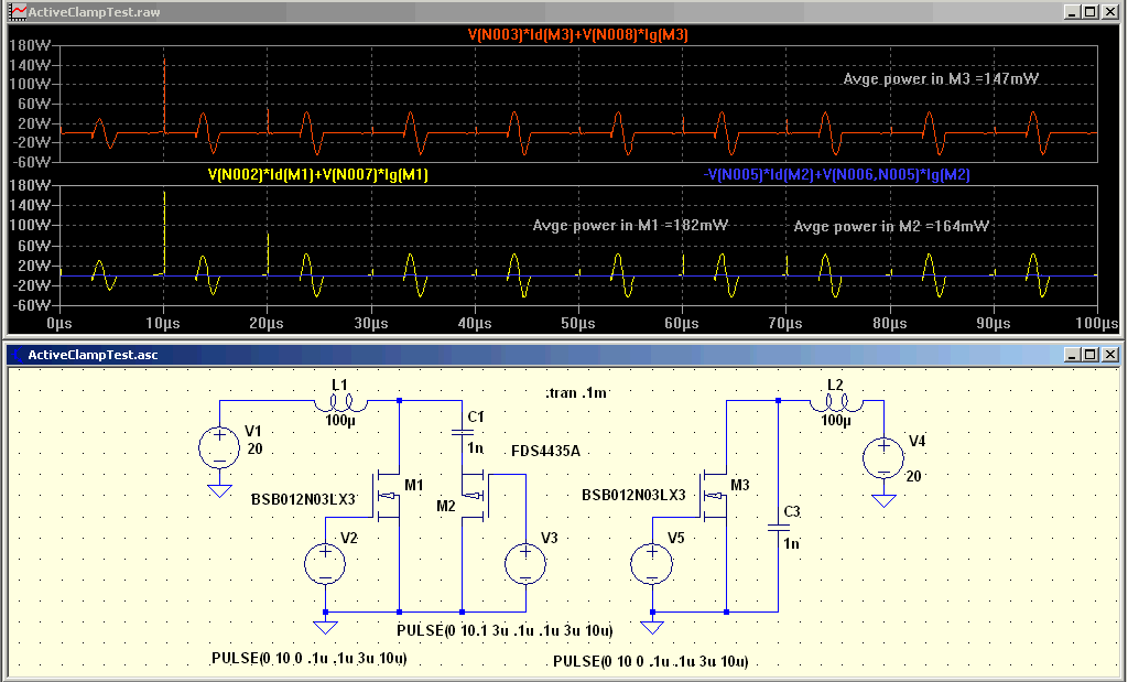

Here's a sim comparing use of (a) an active clamp where the clamping FET switch-on leading edge coincides with the main FET switch-off trailing edge with the use of (b) a simple cap across the main FET (as per Ron, post #7). Interestingly the combined losses in the two FETs in a is only slightly less than if the active clamp were omitted; and the loss in b is less than the loss in either FET in a. So is active clamping worthwhile?
