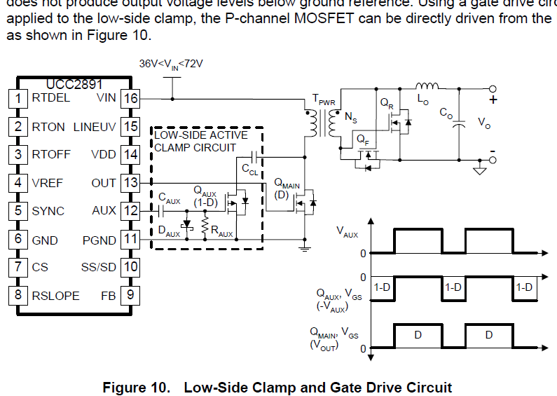

I think above (#17) when you show the gate drives being high and low together, one is for a p fet, and the other is for an n fet, so the fets are not actually on together....Page 778 of Basso's book describes active clamp forward operation.
I think the main advantage of the active clamp forward is the fact that if a p type , low side clamp cap drive is used, then you dont need high side gate drive components at all.
you say the cap voltage is zero...but it isn't, its the clamp cap of an active clamp forward converter, and its not zero, its well above zero.....its actually likely to be higher than vin.

I guarantee that the voltage across that cap is much above zero...when the fet is on, one side of the cap is zero volts, the other side is far below ground.
You'd lose that bet. If both transistors are on during the switch time, how can the capacitor voltage be below ground??

This makes me think that both FETs are only on during the 'cross over' time.
See full data sheet attached.
  • 2004DEC01_MPR_AN02.PDF
the n and p fets are on alternately, not simulataneously
To avoid a high voltage spike, the p-fet should be on slightly before the n-fet turns off, giving a slight overlap in their turn-off and turn-0n.

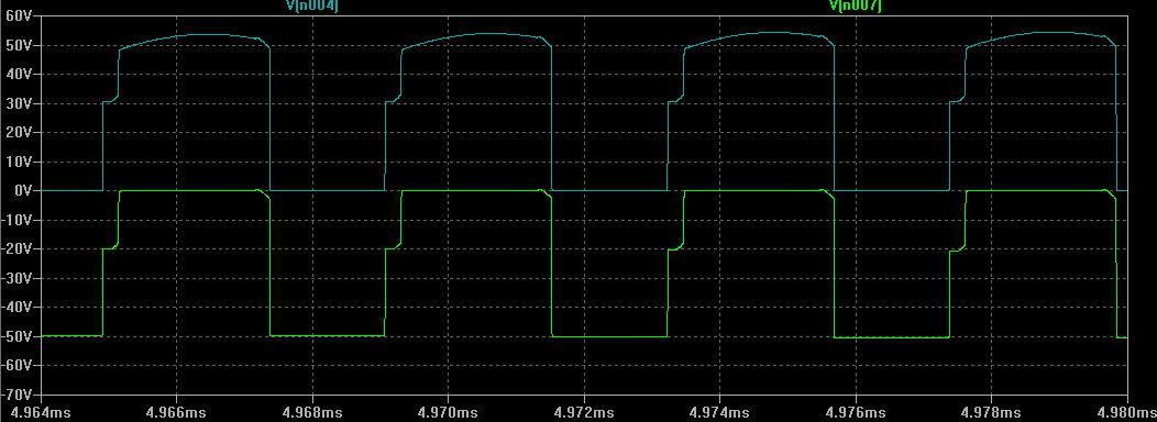

004 is the big N-FET. D-S
007 is the little P-FET. D-S

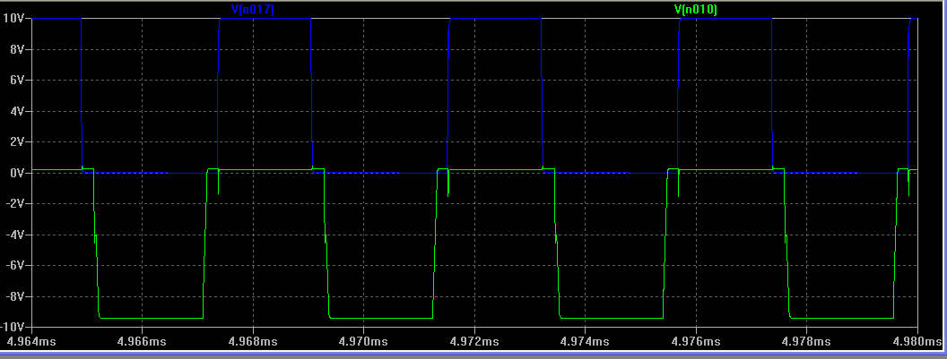

Here is the two gate voltages. Note the P-FET goes negative.
The LTSpice file takes about 5mS to get up and running. Don't even look at it for the first 4.5mS.
  • 3752.asc
