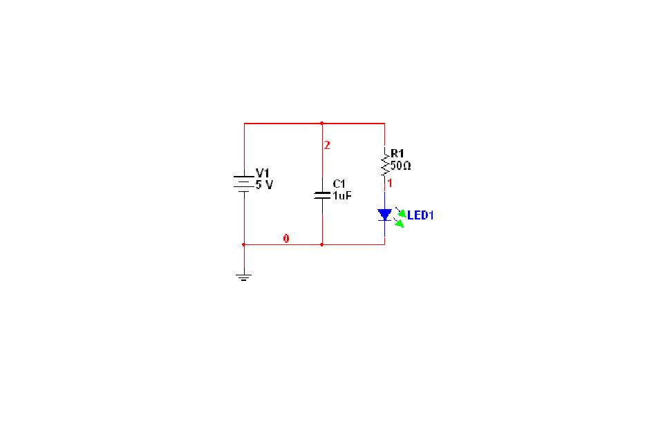

Here is a circuit... I think I will use this first approach and then try to add the led somewere...probably next to V0.
The idea is to have a value at wich the diod will discharge and make a led go on (so I can think about puting the led next to the diod...)

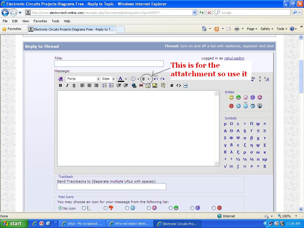

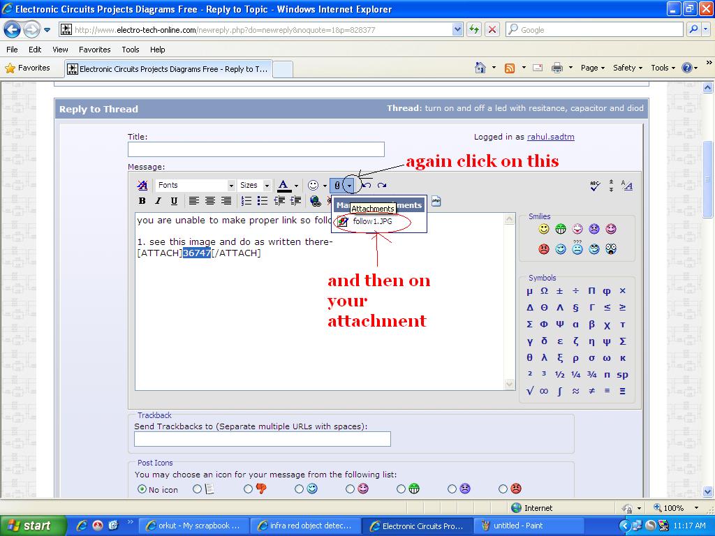

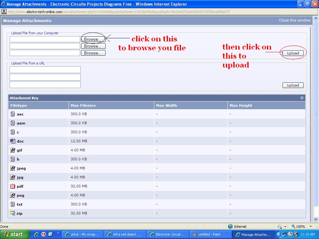

you are unable to make proper link so follow these steps...
1. see this image and do as written there-
and then close this window
do this and post your attatchment
your link was from your hard drive so it was not possible to access image so follow as i have said in my above thread...
If the LED is connected to VO and ground then it will blink one time and maybe will burn out when the battery is connected.
The LED needs a series current-limiting resistor and the capacitor needs a resistor to discharge it when the battery is disconnected.
The diode does nothing.

I think that I have a problem when you say:
"the capacitor needs a resistor to discharge "
How do I make a capacitor charge and discharge simply with a resistor?
The objective is to make the led blink.

dear, capacitor always need a path to discharge. you use a resistor with this capacitor for its discharging.
If you want the LED to blink on and off over and over then you must drive it with an oscillator circuit.
