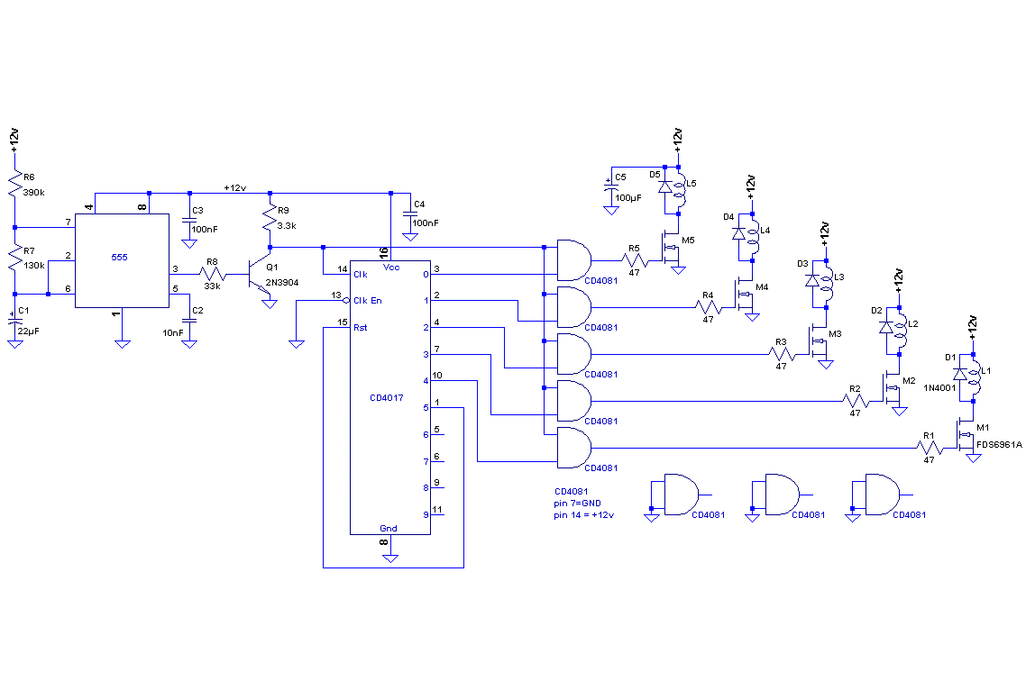

If you don't need precise timing, this should work. I haven't tested it. You can tweak the pulse widths by making changes to R6, R7, and C1. You can pick another MOSFET. It should have Rds less than 1 ohm, and be able to tolerate 12 volts gate-to-source.
air valve driver
The attached schematic should do the job. The NE555 generates a precision 1 second clock pulse. It drives the 4017 which divides the time to 10 seconds. U3 a,b,c, is connected in a OR gate configuration to OR the 0 and 1 outputs to generate a gate 2 seconds wide. The 2N3904 transistor is a LED driver. The 1M pot in the 555 circuit is adjusted so the the time between the LED coming on is 10 seconds. U4 generates two positive triggers one on the rising edge of the the 2 second gate and one on the faling edge. This triggers the second 4017 counter. The outputs are taken from the 0,2,4,6,and 8 outputs. The first trigger from U4 turns on a air valve and the second trigger turns of the valve.

This is getting extremely complicated :lol:
Why not just use a PIC16F628, and driver transistors to feed the valves?, component count - 1x16F628 (cheap PIC), 5xtransistors, 5xdiodes, and a handful of resistors and capcitors. If you don't want to get into PIC programming, use a PICAXE or BASIC STAMP and program it in BASIC.
The previous circuit was very impressive, and showed great design skills, but you could probably write the PIC program in less time than it took to draw the circuit :lol: Plus a PIC based circuit would be a great deal smaller and cheaper - and much easier to modifiy or change.

Except mebbe go with a ULN2003A octal darlington driver........reduce the component count even further.Its rated at 500ma so should survive the loads imposed by the valves.
For those with programming experience, I agree with Nigel. For those who don't, it would be a good first project. A first-timer is not going to do the programming in a couple of hours.
I don't want to get into a pissing contest here, :roll: but if thup, for whatever reason, doesn't want to tackle a microcontroller, I offer a hybrid of my first circuit and k7elp60's. I think the choice of drivers is a matter of availability. I like MOSFETs because they don't have 0.75 volts of drop across them like a Darlington does. I would certainly avoid the ULN2003A in this application because, according to the datasheet, Vce(sat) is almost 2 volts at Ic=500ma. In fact, I looked at that part before settling on MOSFETs in my original circuit.
I changed the timing components on the 555 because I don't believe you could get down to 1 Hz with the values k7elp60 shows.

k7elp60 pointed out an error and some omissions in my schematic (see the next post). The corrections have been made below. I corrected the timing elements in the clock multivibrator and added a power-on reset circuit and an LED for monitoring the frequency. Thanks, k7elp60.
turn on air valves
I do not want to get into a contest, but I think it is important to understand my point of view. I understand Thup wants the valves to be on for 2 seconds and off for 8 seconds, and he wants #1 valve to be on when power is applied, thats why of the power up reset circuitry.
It is my understanding and the formula works for me that the timing calculations for the 555 in the astable mode is: t in seconds =0.693(Ra+2Rb)C. Since the pot and the 560k are in series as Rb we calculate
T=0.693((470K+2(1.06M)).47uf or 0.843 seconds.
If the capacitor is changed to 1uF or two 0.47uF then the pot in Ron H circuit will work, as will my design, only in my design the pot may be near
minimum resistance.
The LED in my circuit is turned on every ten seconds. Since Thup has a stop watch to adjust the the timing to 10 seconds I created the design.

I agree that the mosfets have a much lower saturation voltage than the darlington transistors. Yet most 12 volt relays and selenoid valves will fully energize on 75% of rated voltage and total power consumption will
be slightly less with the darlington drivers.
K7elp60, you are absolutely correct about my timing elements. I have corrected the values, and have added the power on reset and monitoring LED, both of which, as you pointed out, are important. I intentionally left them out on the previous schematic because I was working on it after hours at work and was in a hurry to get home (where I now am).
Thanks for keeping me honest.
BTW, I have no problem with your circuit. I was just trying to improve on my original and simplify yours at the same time. And, as I said before, I have no problem with driving the valves with Darlingtons.
