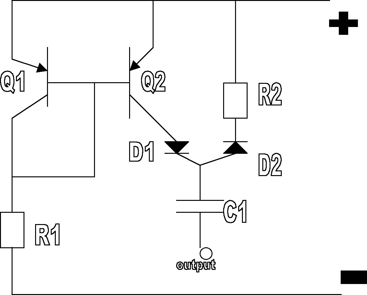

I am trying to build a simple, ramping, linear pulse generator which increases in current much faster than the time to decay for a self designed medical research project.
The circuit design is driving me insane! I need a steep rise and a slow decay and I know I need a capacitor for the pulse behaviour, a resistor to slow the decay time and perhaps pnp transistors to ensure a linear rise in current while charging the capacitor.
but..
how it all goes together puzzles me greatly! Especially where i should attach the outputs for the waveform.
Guys, how can i set up a circuit that gives me a sharp (hopefully linear) current rise and a slowed decay time?
ANY help would be MUCH appreciated!

Thanks for your reply.. I understand what you mean with respect to a 'charging' and 'discharging' resistor-diode setup..but... won't placing even a small resistor before the capacitor (during the charging phase) create a sloping rise on the curve?
Perhaps it won't matter, but i found a different circuit (designed for a different purpose) that used two 'pnp transistors' to create an even charge flow to a capacitor and hence form a linear rise. Though i can't get my head around how or where to place a 'discharging resistor'. It seems everywhere i place one looks as though it will affect charging speed too.
Have any idea just how one could fix this setup?, or even if it will matter if an op amp could do the job for me anyway?

Could anyone check this out to see if it will work how i've described above? In particular have i got R2 connected properly?
cheers team.. you rock.
Michael

You're not fitting a resistor in series with the capacitor, the two resistor/diode combination replaces Rt, which feeds into the opamp. The capacitor goes directly from the output directly back to the input.
You would need to switch the charging/discharging circuits in and out as they were needed.

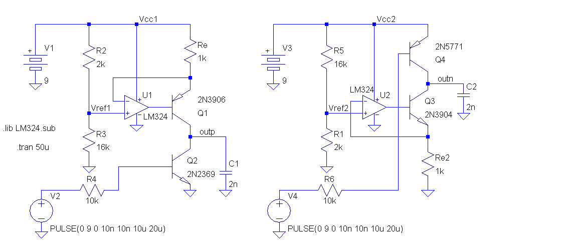

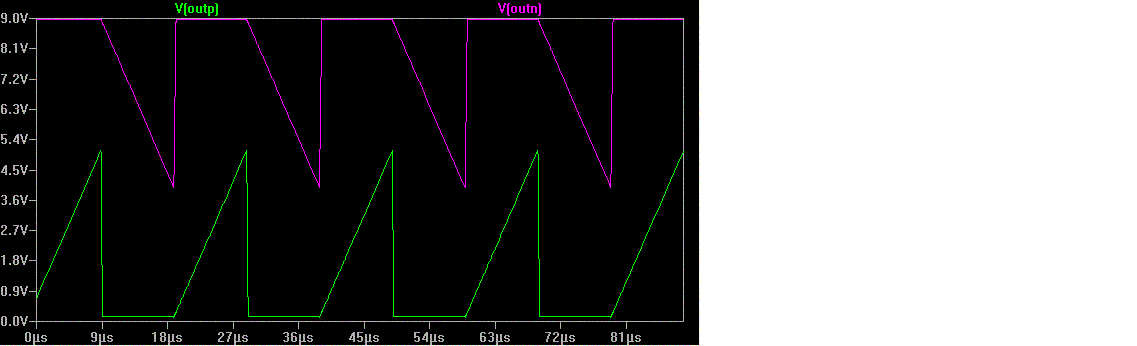

It isn't clear to me which slope ramp you want. Below is a schematic showing general schemes for generating either, along with waveforms. If you need specific modifications, post here.
