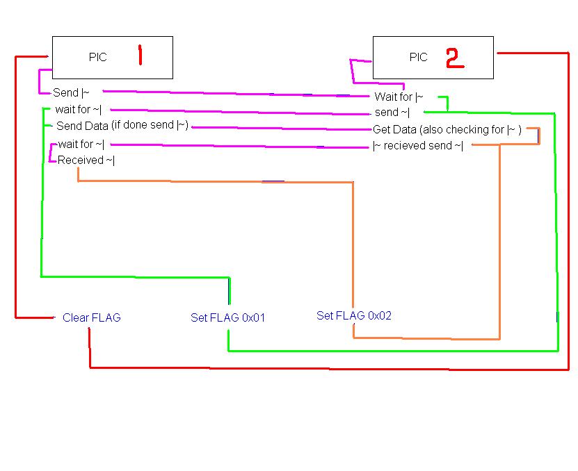

Are you talking about physically disconnecting or software wise? For both its simply the same i guess. Do what Gayan Soyza said but have it set a flag. And only test the flag.
Here is my view:
Create a variable like
char con1;
Have it setup like ...
0x00 nothing
0x01 request acknowledged
0x02 request complete
Now you can have it check the con1 variable and if its a 0x00 send a request
use a timer to check in about 50ms to see if the flag changed
(in your recieve code it can check for anything like 2 characters like |~ this way its less likely false start)
If its a 0x00 still send another request. if you recieved the 2 characters then set the flag to 0x01 meaning we are ready to send data. Once data is sent send out the same characters to the other pic which in turn will send the data back in reverse like ~| this way we know its done and can clear the flag.
So to sum it up..
Let me draw it out for you in paint lol
Here you go:
pic-jpg.33088
I'm sorry, but that is far too complicated.
You are not doing anything different if the data is received correctly or not. Either way, new data is sent afterwards. Therefore there is no need to work out if the data was received OK
This isnt a data check its a connection check heh It will ensure there is a connection before sending the data out hence it wont get stuck when a connection is made. It will get stuck if you break the link mid way tho. But a easy fix is a timer or watchdog clone heh.
Like time it for double your connection speed. A simple definition would help. And use the timer to count. If data hasnt been received for a complete interrupt or 2 of the timer then its a error and can reset the connection by clearing the flag and restarting it.
