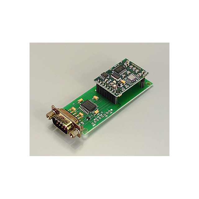

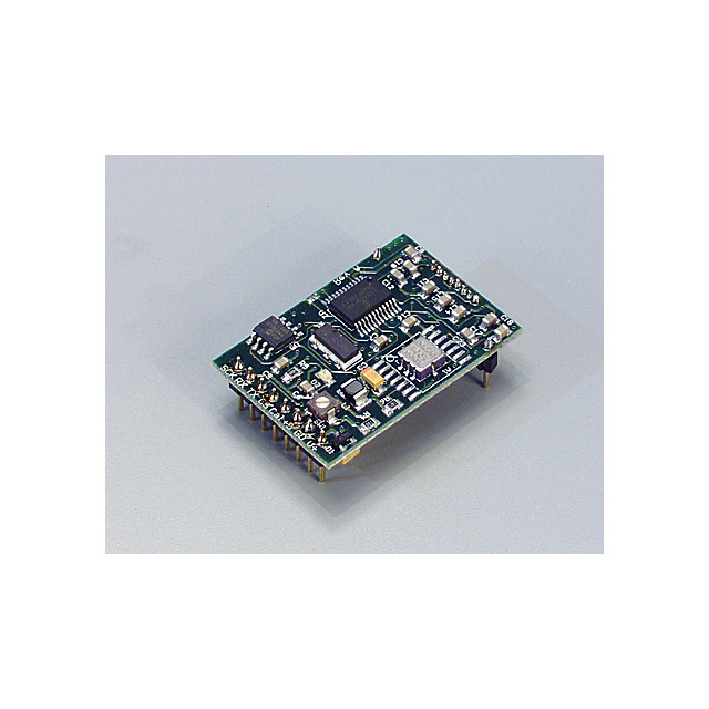

Well, the datasheets say that the UART pins are 5V CMOS compatible. Here is a picture of the compass with and without the RS232 port. I have also attached the dataheets. Please view them and help. How do I connect the pins directly to the PIC? And in the RS232 case, why would I need a MAX? Isn't the MAX needed when I am communicating with the serial port of the PC? But in this case, I don't have voltage levels to change, do I? :? HELP!
The bottom picture, if you look between the socket and the compass board, has a surface mount chip fitted - this will be a MAX232 type chip, which converts from TTL to RS232.
So the output from that socket will be at RS232 levels, so you would need a second MAX232 at the PIC, to convert it back down to TTL levels. Far better (as I said before) to buy the cheaper (non-RS232) one, which will connect directly to the PIC pins.
