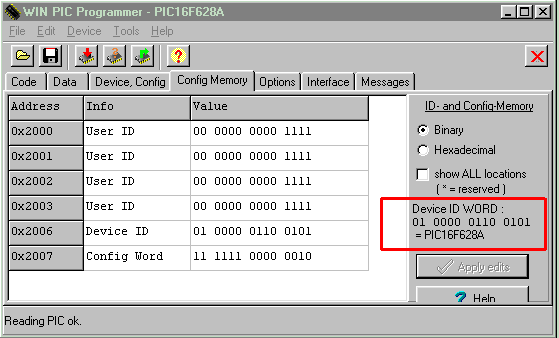

dragonfighter said:
I don't think that it is a hardware issue as winpic initializes my pic succesfully and the interface test works.
I'm most certain that is a hardware issue. All 67(address 0..0x42) of your data words were not programmed into the PIC.
Do a READ operation and confirm you can read the Device ID of 16F628A, which is "01 0000 011# ####", i.e. 0x106? or 0x107? where # can be 0 or 1 and ?=0-F.
Remember you'll need to pulldown the PGM pin(pin10) even though you are using HV programming.
Looks at the following image, if your programmer works then you should also get the device id as I have got.
The problem with serial port programmer is that they might not work and it depends solely on the hardware of the serial port on your PC or Laptop. Serial COM port on very old PC usually works but most laptop COM port won't.
To check, do a READ operation without the PIC and measure voltage across capacitor C1. You should get about 12~13V. If not, then there is no chance for it to work and you have to try those schematic that use separate power supply.
