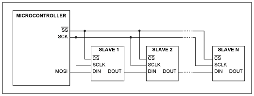

I have a question on the following circuit below (taken from https://www.maximintegrated.com/app-notes/index.mvp/id/3947)
It says there that for this circuit to work, the following conditions must be satisfied - it is condition #2 that I don't understand.
Could you please help me understand condition #2?
1. For daisy-chaining to work successfully, the slave must be able to input a command at DIN during a given command-cycle (defined by the number of clock pulses required to clock in one command), and output the same command at DOUT during the subsequent command-cycle. Stated simply, there is a DIN-to-DOUT delay of one command-cycle.
2. The slave must, moreover, only execute the command written to it on the rising edge of active-low CS.
This means that as long as active-low CS remains low, the slave ignores the command and outputs it at DOUT on the following command-cycle.
If active-low CS goes high after a given command-cycle, all slaves execute the commands just written to their respective DIN inputs.
If active-low CS goes high, data is not output at DOUT.
This process makes it possible for every slave in the chain to execute a different command.
* As long as these daisy-chain requirements are satisfied, the microcontroller only needs three signals (active-low SS, SCK, and MOSI) to control all the slaves in the network.
Thank you very much!
I don't see what is wrong.
There is a shift register from Din to Dout. Often 8 to 16 bits long.
If CS=1 there is no shifting.
If CS=0 data is shifted with every clock. (and the slave does not respond to the data)
On CS rising edge the slave does something based on the data/command that is in its shift register. (does not know about the data that passed through many clocks ago that is now down stream)
Oh I see.
Thank you very much Ron and 4P.
So, these are "speical" slaves, in the sense that when nCS = 0, they take the DIN data that they received in this cycle, and shift it to DOUT in the next cycle, and when nCS goes High, they actually act like normal slave and perform the command that appeared in Din.
They are not "special". This is how slaves work.
example: if the slave is 8 bit it only stores the last 8 bits and anything before that is forgotten.
