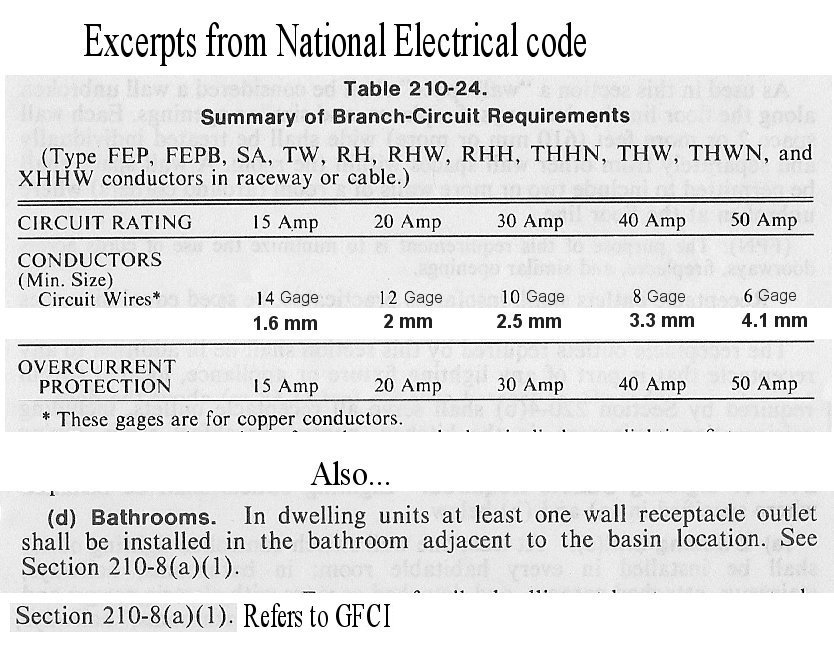

You are right Nigel, we do use heavier wire. Really light circuits, we might use 16 gage wire which is 1.3 mm. That isn’t even on the chart for outlets. More like lamp cord or cheap extension cords.

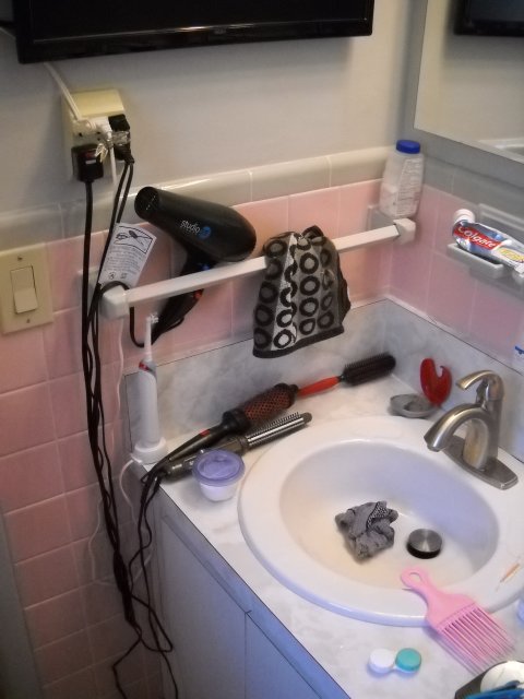

American bathrooms often look like this!
On the other hand, it keeps the mess contained.
My girlfriend says she needs a bank of outlets and much more counter space.
The TV is new this Christmas.
Both of these bathrooms are in violation of current code, though they may have been compliant when built depending upon just when that was. I don't know exactly when GFCI protected receptacles (same as what you Brits call RCD) were first required in bathrooms but I do know that the requirement was tightened not too long ago. When GFCI protection was first required, any receptacle within 5 feet of the edge of a sink or bathtub had to be GFCI, but now it's any receptacle in a bathroom, regardless of how large the bathroom and how far from the water the receptacle is. One of my late uncles had his master suite remodeled so there was no clear distinction between bedroom and bathroom areas, so to be in compliance probably all of the bedroom receptacles would have to have been GFCI protected as well, though I don't remember if they actually were.
BTW, a receptacle does not need to be a GFCI in order to be GFCI protected. It is generally permitted here to wire one or more standard receptacles "downstream" from a GFCI receptacle (by properly using terminals provided and so labeled on the device), or to use a GFCI circuit breaker in the panel to feed the entire circuit. Code requires that any such remotely-protected receptacles be durably labeled as "GFCI protected". We don't use the "ring circuit" mains system that came into use in the postwar UK to save on copper usage, so adding a GFCI protected spur to an existing system, or converting an existing spur to GFCI, using a single GFCI device to protect one or more other receptacles is trivial.
