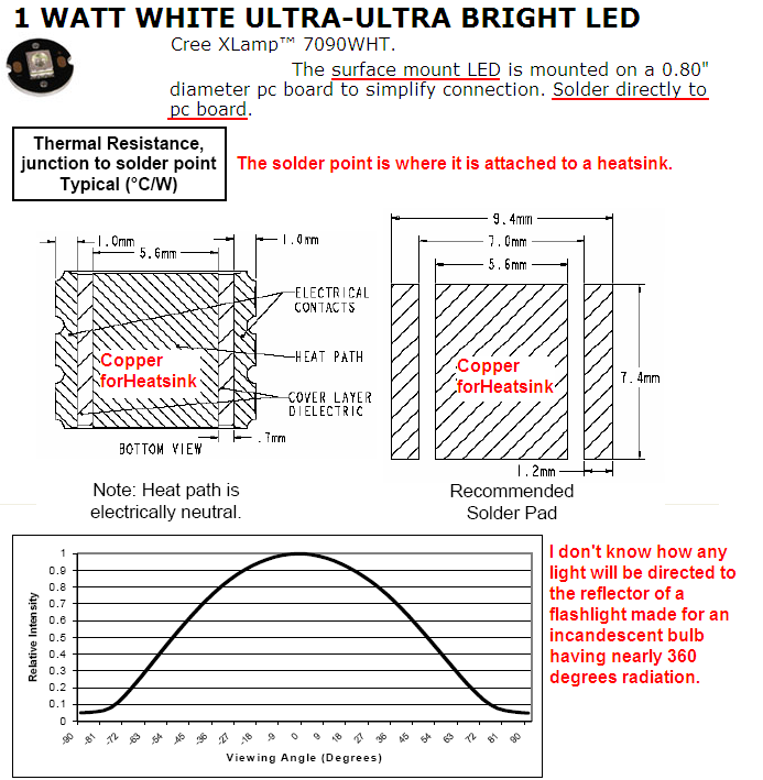

My Cree Xlamp is already soldered to the aluminum PCB heatsink, it came that way. Oznog said I will need further heatsinking besides this, how am I to do that?
Cree's datasheet shows that it needs to be soldered to a pcb so that it can use the pcb's copper as a heatsink, when its current is more than about 150mA.
Actually, the reflector makes a HUGE difference in directivity and I am going to use it.
OK, but I don't see how since hardly any light will radiate sideways to the reflector.

Lots of confusion is ended. Look what I discovered:

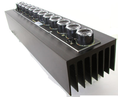

That's not a heatsink, THIS is a heatsink :)

I don't think Zach should put a couple hundred Watts into his little LED! :lol:

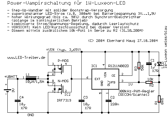

I found a place with some LED driver circuits das ist in German, Yar. I can make out what they are on about and they have a step-up (Vampirschaltungen) luxeon circuit (i know zachs isn't a luxeon, but close) that they claim is 90% efficient and usefull down to 1.9V.

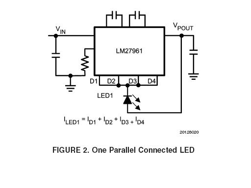

williB, That driver is only good for ~80mA when paralleled, I don't think that's enough to drive zachs' LED? even with a 3.6V input the best you could get from it would be ~0.4watt, NiMH or Nicads probably would work at all?
It would be great driving 4 20ma LED's from a lithium battery though :)

I don't know if its 4 outputs can be paralleled like you show. They don't provide nealy enough voltage or current for Zach's flashlight. His 3V battery voltage will drop to 2.0V over its life and his "super LED" takes up to 350mA. The minimum input voltage and each output on National's tiny IC can supply only 20mA. :(

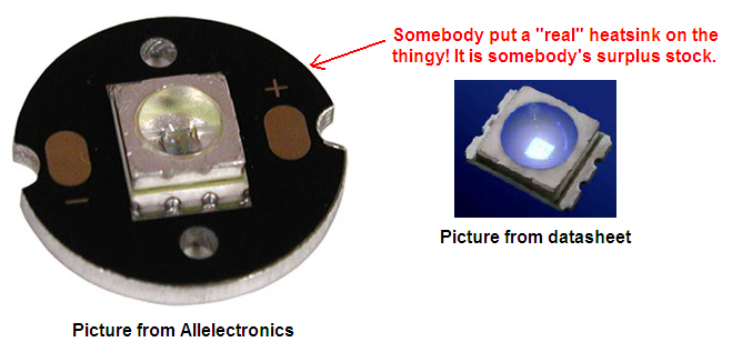

That's what I've been trying to tell you audio! There is already a heatsink!!

When I saw the datasheet, I thought that you had just that IC. Only recently I realised that somebody put it on a heatsink for you. :lol:

Hmm, that's odd? i will just post the schematic then, it's probably not any better than the silly chip circuit, just wanted to share what i found, be good if someone could do a pepsi challenge and see if it is more efficient.
zachtheterrible said:
I really just want to build the circuit that Chiba gave me. the silicon-chip, chip-torch one. Is that a good solution or bad?
I think it's great :) Incase anyone missed it, it's in this link:
