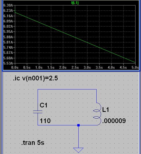

What i meant was a coil's magnetic strength is proportional to the current through it..
ie more current more magnetic strength.
in the circuit below there is no initial current , but the voltage on the cap is initially 2.5v.
as you can see the current instantaniously jumps up to around 6.23 A
In this circuit the resistance of the coil has a lot more of an effect than the inductance , on the current .. the coils resistance is .4 ohms..
after it fires you could allways just shot it off .

Put some reasonable resistance and inductance into your coil then stretch the timebase of the 'scope (milli-seconds) to show the slow rise of current in an inductor.
The projectile might be gone long before the coil's current reaches max.
I think that 10mH is a reasonable value for a coil that is 0.4 ohms.
Then it will reach half current in 17.5ms, and max current in 125ms.
It will cause the projectile to move very slowly.
Why doesn't your sim show an exponential discharge current of the cap?
