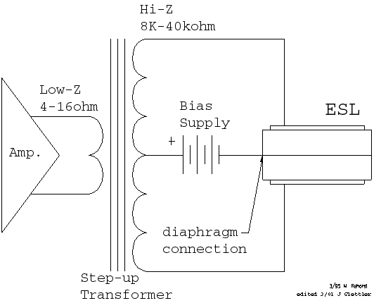

The thing I am having the most trouble with now is figuring out hwo to bias the transducer. it recommends a max AC signal of 200Vp and a DC bias of 200V. I can see how to get 200VAC from regular logic with a transformer (assuming I can find a high frequency one that works 40kHz-60kHz). But I don't understand where you would get 200VDC from, and apply it to the transducer, especially if there was a transformer also connected to the transducer leads (wouldn't that destroy the transformer?)

I was quite suprised when I saw the voltage requirements myself- seeing as how everythingn I've seen before that has been piezo rather than electrostatic. But it must be possible, since SensComp has "Smart Transducers" where all the circuitry is crammed onto a PCB that sits on the back of the transducer.
I was hoping to get a range of 6m- this was typical with the piezo sensors I've been using. But these transducers seem to be able to work out to 10m since they are more sensitive than piezos.
This diagram seems to be representative of how to DC bias the transducers-
Seems like I might need a 5V to 200V DC-DC converter not to mention transformers which I have been unable to find (SensComp also has some but they have so few specs I can't figure out how to use them). BUt the Smart Transducers don't have anything as big as DC-DC converter on them, so I'm wondering how they did it!

I didn't think piezo required a bias voltage. That looks more loke a condenser mic working in reverse.
These are electrostatic <condensor-type> transducers. If it was a piezo, it would be easy. No bias needed and only low voltage AC is required. But they have non-existent bandwidth and crummy sensitivity.
I don't think the bias is a huge problem now (though I still don't know how the guys at SensComp got it so small). A really low power 200V DC-DC converter should work since it's really just a capacitor so there aren't any real current requirements apart from charging up the transducer.
