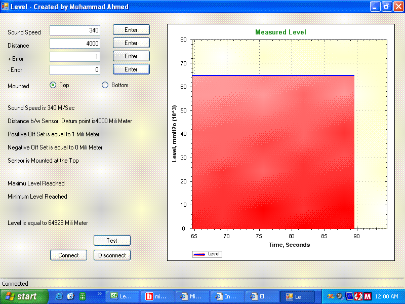

My Software
Below is the Picture of software made by me for Sending data and receiving.
I made in VC#.
Rate this??
