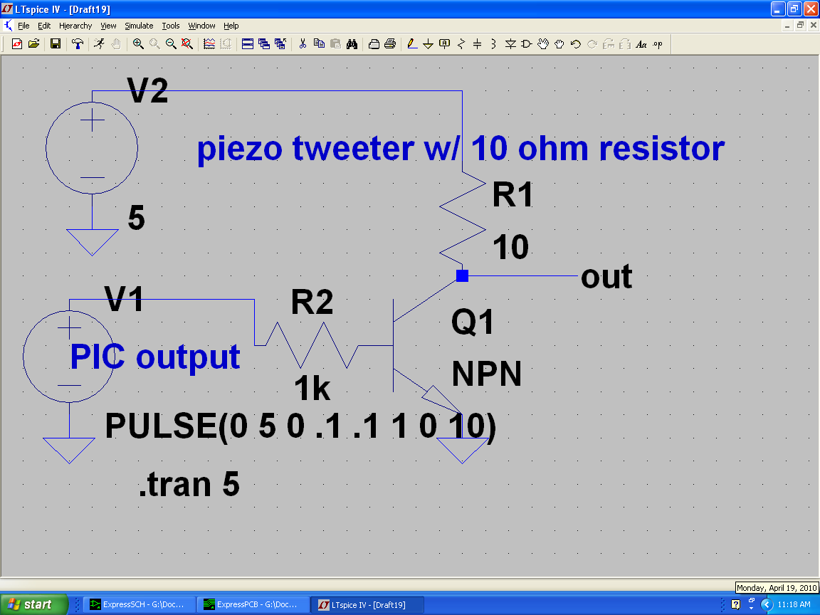

Thought about inserting a transistor on output of 555 or PIC so the 555 or PIC has less current drain.

here is what I am thinking as the amp when used will need some resistance and the transistor will reduce the current drain on the PIC output?

Piezo tweeters are driven with voltage, not current. Your transistor has a lot of current but nearly no voltage and will cause a very low level of sound.
The piezo tweeter has a max "power" (if an 8 ohm coil and magnet speaker is used) of 50W which is a voltage of 56.6V p-p. Your transistor might have an output as high as 3V p-p.
Amplifiers are push-pull. Most of their power goes to the speaker. Your transistor wastes half of its power heating the 10 ohm resistor.

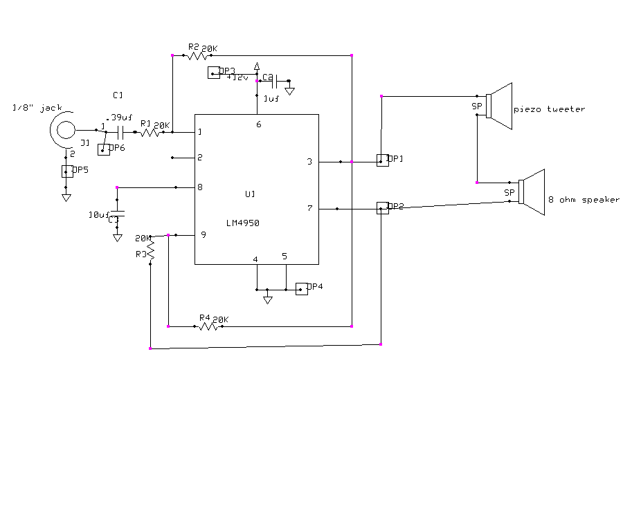

stupid idea or not
To put a load on the amp what about putting an 8ohm speaker in series w/ piezo tweeter?
Yes, a stupid idea (in every respect), why would you want to do that?.
Assuming there was any valid reason for adding an extra load (and there aren't really), you would put it in parallel with the piezo.
I thought about parallel but then it was mentioned to add a 5 watt 2-10ohm resistor in series with the piezo tweeter.(LM4950 amp or the TDA1518BQ, what ever I can get. Don't want alot of volume. Deer can hear up to one mile away.
As we've repeatedly mentioned, high frequencies don't travel very far - and why would a deer be scared of a barely audible noise a few yards away?. For any hope of it to scare deer away you will almost certainly need LOT'S of power.
The resistor is to protect both the amp and the piezo, but as you're only using low powers it's probably not needed.

Thats why I thought of connecting in series from Vdd to tweeter to transistor to ground as per LT Spice diagram I posted. see post 65
the 10 ohm resistor is supposed to be the tweeter.
Post #65 shows a 10 ohm resistor as a heater. A speaker would burn up with that much continuous current in it.
But a piezo tweeter has no resistance because it is actually a capacitor so the transistor "amplifier" will not work.
A push-pull audio amplifier with enough output voltage swing (from enough supply voltage) will work.
