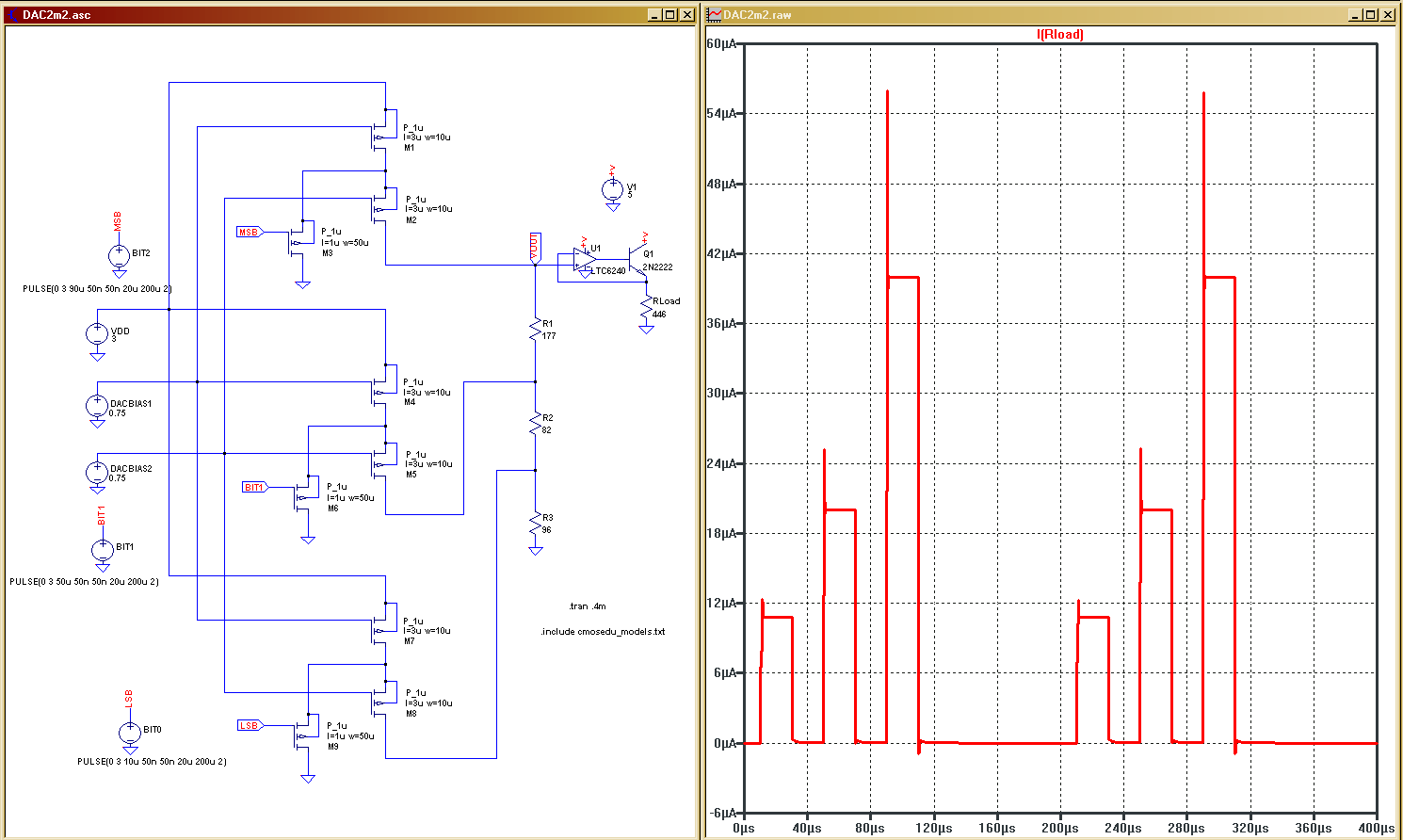

I cannot find a SPICE model for Ca3140. They have data sheets for them but no SPICE models for them, even though they do have models for other ICs in their range.
You can any good OPA with a single supply operation specification, try the LT1006 in OPA folder

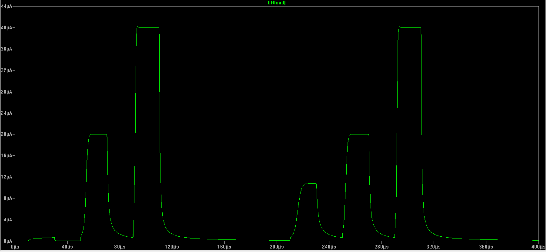

i do not know why when i measure the graph the first period i get zero micro Ampere.
Replace the OPA with a LTC6240, it is the F2 OPAMP list.
