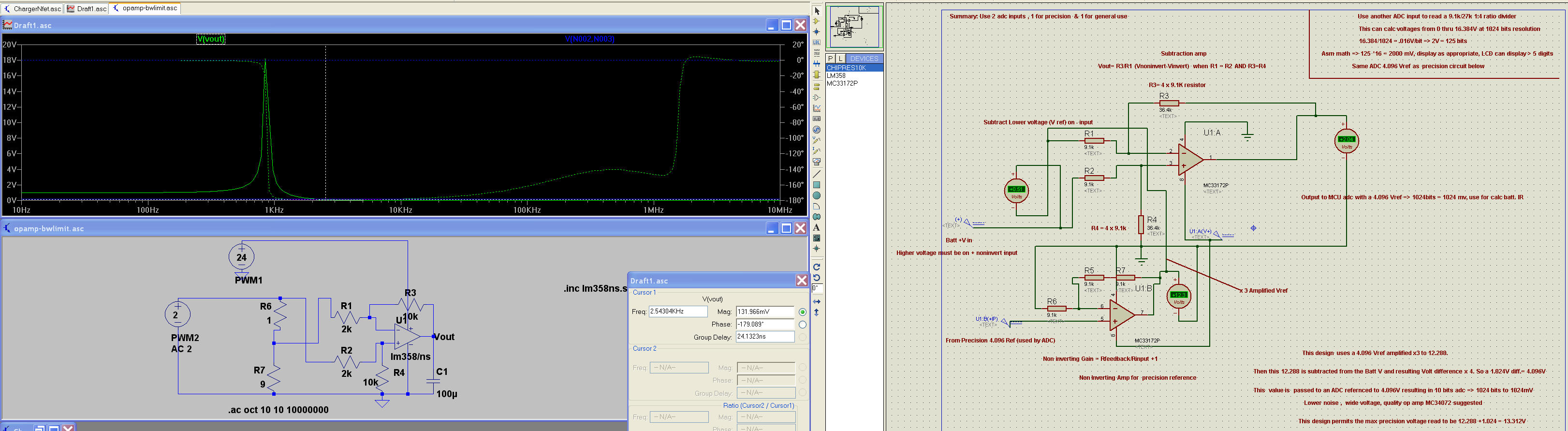

Well, I am reading the voltage impressed on a .05 ohm current sense resistor, with either a constant 4 or 8 amp load. The intention is to calc. the int. resistance of a lead acid batt. which can be from under .01 ohm to perhaps .1 ohm.
The diff amp is fed by a 12.288 V offset and is measuring a 1.024V range up to 13.312V as a battery can vary in charged voltage depending on temps by a few tenths of a V. Nominal resting full charge is about 12.8Vdc.
As the input range of the diff amp is 1.024V max diff. it does a 4x gain to deliver a 0-4.096 V to the MCU ADC (Ref'd to 4.096V) . The MCU can calc the internal resistance of the lead acid based on V=IR given the open loop Voltage of the Batt vs the loaded voltage of the batt. You can see that at a .01 ohm Int res. the batt will only drop 40mV under a 4 Amp load. So I need to control the 'noise' voltage by limiting the bandwidth as you have described. Perhaps to something like 2mV max? I can do multiple ADC samples to avg out small noise.
I included an attempt at filtering the Opamp gain The bode plot shows a big spike just before the gain collapses around 1Khz. Otherwise the gain is 1% stable from under around 80Hz which is good as we are looking at DC loading over the sense resistor. Is this how to approach it?

Now that I finally understand what you are trying to do I can better help you. (Why does everyone always ask for help to try to solve the design problem the think they have rather than solving the application problem they do have?):rolleyes:
First, you can't control the frequency response by adding a capacitor directly to the output of an op amp. That's whats causing the large spike in the frequency response. You need to add a resistor in series with the output to the capacitor.
Second, a high side current monitor circuit should work better for you than an op amp configured as a differential op amp. They are optimized to do what you want.
The common-mode rejection of an op amp circuit is no better than the matching of the resistors, thus with 1% resistors the CM rejection is only 40dB. That will give large errors as the battery voltage changes.

BTW is this bandwidth limiter as u describe...it seems to work now.

Yes, those are typical high side current measurement circuits. They need an instrumentation amplifier or a rail-to-rail input and output type op amp, depending upon the circuit..

The amp you have now doesnt look too bad really. You could improve a little by increasing that 100 ohm resistor on the output to 470 or something like that so the op amp output isnt loaded as much.

I attach a simulation of the requisite current sense as well as battery voltage sense with comments on the integer MCU calcs...which give a best accuracy of .04% incl the opamp offset V. Now, it's just about getting decent resistors or manually matching them up, or using trimmers and calibrating them. I'm looking at using arrays to help with consistency.
